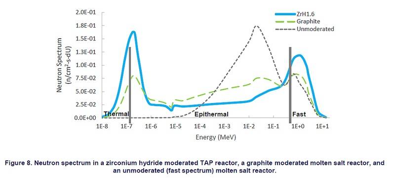

Extensive reprocessing of spent fuel / waste before reuse in a reactor is a prerequisite of existing, *solid* fueled reactors. Such is not a requirement for other designs, in particular liquid fueled reactors where fission products that interfere with the reaction are allowed to out gas relatively simply. With efficient use of neutron spectrum in thermal and fast regions, the transuranic wastes produced in traditional lightwater PWRs would be consumed.
http://transatomicpower.com/white_papers/TAP_White_Paper.pdf
Likes Evanish

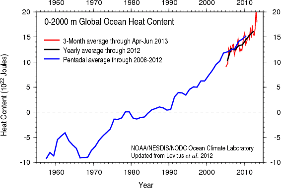

The ocean is a giant heat sink. At least the heat from nuclear powered ships will dissipate relatively quickly. The heat being added to the oceans from burning fossil fuels will keep being added for a very long time.
  • #35
Direct heat is not an issue for global warming, as it does not change the equilibrium temperature (and the nuclear waste is there anyway).
Diesel has an energy density of ~50 MJ/kg, spread over one week this gives 80W/kg - a factor 800 above the value QuantumPion calculated for americium. Ships would not be happy if they had to carry 800 times more fuel, even if that fuel would last "forever".
