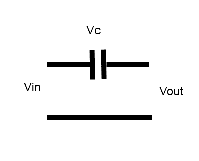

It will pass high frequency ac but resist changes in voltage. This does not make sense to me. With a high frequency signal the voltage is changing constantly. Does it mean the peak to peak Voltage??
Think about what you mean by "pass". Consider the circuit shown below..
If the signal to "passes" through the capacitor the output will follow the input. In other words the output voltage is the same as the input voltage. That means the voltage across the capacitor is constant.

Just look at the voltage across the capacitor, not the whole circuit. At high frequencies or a large capacitance the voltage across the capacitor barely changes since the capacitor doesn't charge/discharge much. At low frequencies or a low capacitance the capacitor charges/discharges more, so the voltage across the capacitor changes much more. In the case of a DC circuit or when the AC frequency or capacitance is low enough, the capacitor completely charges and discharges, so the voltage across it completely changes to match the applied voltage.

This is incorrect. Consider a capacitor with a very large capacitance. When we close the circuit the capacitor acts like a short and current flows, charging it. Initially, the voltage across the capacitor is zero. As the capacitor charges the voltage increases until it matches the applied voltage. When the applied voltage falls, the voltage across the capacitor initially remains at the peak voltage and then falls off gradually as the capacitor discharges. In the case of a high frequency circuit the voltage across the capacitor barely changes even though the applied voltage alternates back and forth. If we partially charge the capacitor and then apply a high frequency AC signal, the voltage across the capacitor remains approximately the same as the signal alternates. When we say that the capacitor resists changes in voltage, we mean that it resist changes in voltage across itself.
Thanks for all your replies folks. I was thinking about it the wrong way.
