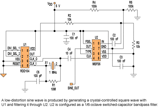

Here's a clever one that works as you suggested, remove harmonics from a square wave with a sharp filter:
http://electronicdesign.com/analog/standalone-circuit-converts-square-waves-sine-waves
looks like a pure digital synthesis is not possible, just an approximation that can be refined by old fashioned filtering.
