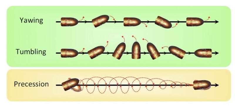

Rifled bullets are gyroscopes: precession maintains the center of pressure before the center of mass. A side effect is deflection from yawing (aerodynamic jump) and pitching (spin drift). Spinning bullets and gyroscope diagrams show opposite forces.
1) Bullet spin causes a bullet to become a gyroscope. Specifically, bullets have their center of pressure in front of their center of mass. Therefore, when pressed, gyroscopic forces cause a bullet to spin 90 degrees instead of tumble. See this diagram:
enter image description here

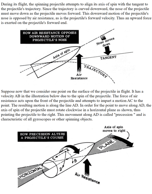

2)The precession does not cause the bullet to point into the direction of movement, but the direction of apparent incoming wind. That means that if there is a crosswind of 20mph, the bullet will turn slightly to point towards the incoming wind while traveling straight forward. See this diagram:

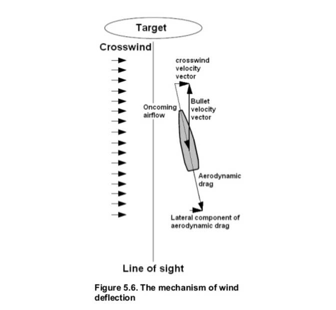

3a) As a bullet drops, there is apparent wind coming from the downward direction. Apparent wind occurs when there is a differential between the object and the surrounding medium. Therefore, the bullet turns down as it drops. See this diagram below.
3b) Importantly, gravity accelerates, so there is always an increasing apparent wind as the bullet falls. This accelerating vertical apparent wind causes continuous forward rotation of the bullet.

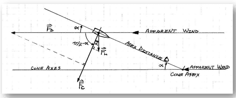

4a) Air resistance forces to the front of the bullet and those to the side of the bullet cause different behavior. Air resistance to the front causes the bullet to reorient into the direction of the incoming force. (See the first image.)
4b)Air resistance to the side of the bullet (i.e., from the left, up, down, or right directions) pushes the bullet to point 90 degrees clockwise to the incoming air. So left-to-right crosswind cause aerodynamic jump down and a or right-to-left crosswind causes aerodynamic jump up. (Note the horizontal defection in this image is due to the crosswind, which is distinct from spin drift.) See this diagram:
enter image description here4
5) Therefore, intuitively, when a bullet rotates down due to being in a falling trajectory with gravity, it points to the right if it has a right-hand twist:

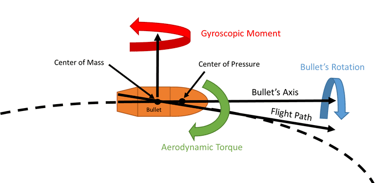

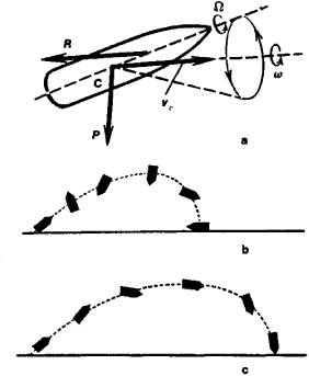

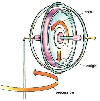

6) But every diagram I see of a gyroscope has the gyroscope rotating the opposite direction.
7) I can’t figure out why the bullet gyroscope rotates in the opposite direction of other gyroscopes. This is not Magnus effect! From Modern Exterior Ballistics, McCoy, “Although the Magnus force acting on a spinning projectile is usually small enough to be neglected, the Magnus moment must always be considered.” Note in the diagram that the Magnus moment points down, and not the to left or right. See these diagrams:

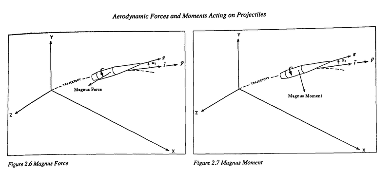

8) In contrast, spin drift is related to the pitching moment, which does point left or right. See the below diagram. Importantly, bullets do not roll off of air. Indeed, if that were the case, then the rear has more surface area and it would cause the bullet to point away from the incoming air flow which is not the case.
9) Something to note is that the traditional depiction of bullet rotation may be somewhat inaccurate. (I cannot confirm.) Traditionally bullets are depicted as rotating around the center or mass. Instead, they may rotate around an independent axis. See this diagram:
The aerodynamic torque in that diagram has the wrong direction.
Likes berkeman
I suppose the label "aerodynamic" is misleading, as you are correct, the lift force causes torque in the opposite direction
However, it is spin-stabilization/gyroscopic-precession that redirects the lift force into an aligning force. Without the green arrow, the entire concept of spin-stabilization falls apart, as spin-stabilization by definition orients the bullet into the apparent incoming direction of airflow.
Perhaps "net vertical torque" would be a better label?
johnlpmark said:
The bullet tips into the direction of the incoming air (called weather-vaning). From the perspective of the bullet, this is a forward rotation.
.... a right spin should force a forward rotation to induce a left turn.
You seem to conflate the change of the bullets orientation with the aerodynamic torque acting on the bullet. You call both "forward rotation", but in the second instance you seem to actually mean the aerodynamic torque, and its gyroscopic interaction with the spin.
For fin-stabilized-projectiles this aerodynamic torque would indeed act to push the nose down (forward rotation). But for spin-stabilized projectiles this is not necessarily the case, as the diagram you posted shows. Here the drag force R passes above the center of mass C, thus acting to lift the nose (backward rotation):
Where is that definition?
What you are suggesting would require the bullet have tail fins, or fletches, and that it not spin, so it can fly parallel with the trajectory, like an arrow.
Spin stabilization causes the bullet to maintain its axial orientation, while the airflow around the bullet is not aligned exactly with the bullet axis. That causes the bullet to walk sideways in flight.
"Spin stabilization causes the bullet to maintain its axial orientation." This is not true in any reputable source. What references are acceptable to you so I can provide them?
Static stability does not maintain the gyroscope in its orientation in space, but maintains the orientation of the gyroscope in the direction of of the overturning moment. - http://ffden-2.phys.uaf.edu/212fall2001_Web_projects/Isaac Rowland/Ballistics/Bulletflight/stab.htm

I will avoid responding to your anger and emotion.
The purpose of spin stabilization is to maintain the orientation of the bullet in a way that reduces the drag force.
I was referencing the fact that if the bullet maintained its orientation in space for the entire trajectory, then the orientation of the bullet would actually be detrimental at long distances. This is because facing perpendicular to the incoming airflow would create a larger surface area than simple tumbling or a spherical round.
This is less evident in rifle rounds, but is very evident in artillery rounds which are fired at much greater angles such as 45 degrees. Check out these undisturbed, unexploded WW1 and WW2 artillery rounds, which were all ended up with some degree of downward facing and did not have fins.

I'm assuming this refers to the magnus force "That causes the bullet to walk sideways in flight."? If not please clarify. The magnus force is does not significantly contribute to the sideways movement of bullets, and I will city McCoy “Although the Magnus force acting on a spinning projectile is usually small enough to be neglected, the Magnus moment must always be considered.” Can you please expand on what this means? Thank you.
Not just lift. Even pure drag force at that CoP would pass above the CoM and act to lift the nose.
No, there is no such torque.
johnlpmark said:
First, I'm not sure that "R" refers to drag; usually that is Fd (force of drag).
You originally posted that picture. You should provide the definition of the labels. I assumed R = resistance

johnlpmark said:
Also, why would a component forces (lift force) be more relevant than net force?
The total aerodynamic force (lift and drag) is what creates the aerodynamic torque around the CoM. Gravity doesn't create a torque around the CoM.

"Not just lift. Even pure drag force at that CoP would pass above the CoM and act to lift the nose."
Lift and drag are vertical and horizontal components of total aerodynamic force, so I agree you are correct since this is a rotation, but is this a distinction without a difference?

This video might help to understand the basic mechanism:
johnlpmark said:
I appreciate the responses. How does the spin axis reorient in a forward rotation to the incoming airflow without it being called a torque?
Torque is the rate of angular momentum change, which is different from the axis around which the spin axis rotates:
http://hyperphysics.phy-astr.gsu.edu/hbase/rotv3.html
And the spin axis doesn't do a simple forward rotation, but precesses around the velocity vector, as indicated by the cone in the diagram.

"Torque" has a specific meaning in physics. Look at the video with the satellite: There is no torque (called "twisting force" there) around the axis that the orbital plane tilts around.
So that answers one question, but shifts to another. How does spin stabilization or an aerodynamic upwards, overturning torque (pitch-up) cause the spin axis to rotate down (pitch-down) without there being another, opposing torque? (Drag force changes velocity but not rotation, meaning that the lift force is the only torque acting on the bullet during its flight that could cause rotation.) As I understand it, precession works at 90 degrees, not 180 degrees?
The instantaneous axis that the spin axis rotates around is perpendicular to both (parallel to the cross product of both): the spin axis and the applied torque. See the satellite animation.
If initially the bullet is only pitched up, the initial instantaneous precession will rotate the spin axis sideways (cross product has no sideways component). But as soon the spin axis is rotated a bit sideways, the cross product will have a sideways component, so the spin axis rotates slightly down too. This happens continuously all the way around the cone pictured in the diagram above.
See also precession of a spinning top:
http://hyperphysics.phy-astr.gsu.edu/hbase/top.html

As the diagram pertains to bullets, what is very important is something not shown which is ΔΦ, or change in the angle between the direction of torque and the spin axis. In all the diagrams I have seen, Φ has been set as a constant for simplification. However in actuality, Φ clearly changes over time.
Is ΔΦ < 0 equivalent to dynamic stability, while ΔΦ > 0 equivalent to dynamic instability? http://ffden-2.phys.uaf.edu/212fall2001_Web_projects/Isaac Rowland/Ballistics/Bulletflight/stab.htm
I think that the question of why bullets differ from typical diagrams of gyroscopes is that in typical diagrams, Φ is 90 degrees (i.e., the spin axis is perpendicular to the direction of torque). Therefore, the spin axis aligns to the direction of torque with both positive and negative ΔΦ. In contrast, with the diagram of the spinning top, only ΔΦ < 0 does the spin axis align.
The difference is that ΔΦ > 0 occurs because gravity creates torque versus ΔΦ > 0 occurs because precession occurs at a speed that redirects that torque at greater rate that it occurs. Does this all sound right?Thanks
