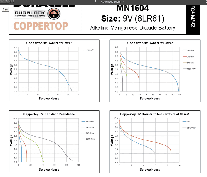

Here's the datasheet for that battery. It is indeed 'plain vanilla' , an unremarkable but pretty good battery.
https://d2ei442zrkqy2u.cloudfront.net/wp-content/uploads/2016/03/MN1604_US_CT1.pdf

Thanks for the response. I'm still going to go with the assumption that the specific reference to a model # is just a matter of the model # of that brand at the time that they tested so recommended that known entity, and/or were paid to promote it. I don't think the exlusion of other brands/model #'s means much at all. Just looking at specs of different 9V batteries at the DuraCell site:
https://www.duracell.com/en-ca/techlibrary/product-technical-data-sheets?region=262&type=303
Yes, there are differences, but they seem slight, and probably irrelevant to a smoke detector. I see Internal Resistance of ~ 3 Ω on one model and 1.7 Ω on two of them. Significant, but I doubt it would make much difference at the currents these use.And they'd need to draw some fairly large current to test that delta and use some fairly precise voltmeter - I just can't see the point.
the charts show a service life of ~ 1 hour @ 250 mA, I can't imagine even the intermittent siren would draw more than that, they would want that siren to operate for maybe an hour even near the end of life of the battery. And that I*R delta would only be 0.325 V @ 250 mA, so really not a big deal.
