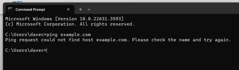

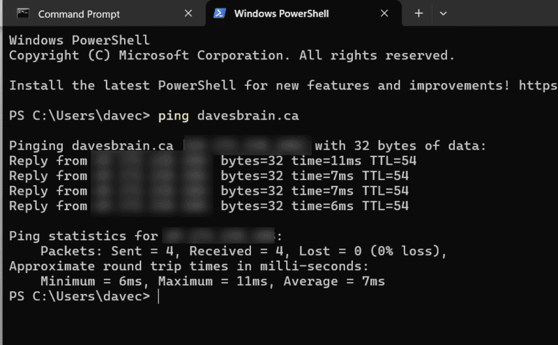

Do you know how to open a Command Prompt on your computer?
Do so, and then type ping example.com:
Bad ping:
Good ping:

I get this for example.com
example ping:
Pinging example.com [93.184.215.14] with 32 bytes of data:
Reply from 93.184.215.14: bytes=32 time=167ms TTL=53
Reply from 93.184.215.14: bytes=32 time=168ms TTL=53
Ping statistics for 93.184.215.14:
    Packets: Sent = 4, Received = 4, Lost = 0 (0% loss),
Approximate round trip times in milli-seconds:
    Minimum = 167ms, Maximum = 168ms, Average = 167ms
And this for gmail.com
gmail ping:
Pinging gmail.com [142.250.70.229] with 32 bytes of data:
Reply from 142.250.70.229: bytes=32 time=7ms TTL=60
Reply from 142.250.70.229: bytes=32 time=9ms TTL=60
Ping statistics for 142.250.70.229:
    Minimum = 7ms, Maximum = 9ms, Average = 7ms

This is not going to help: the only external domain that the server script accesses is smtp.gmail.com and it is clear that something is getting through to the SMTP service because the OP's gmail inbox contains an error report.
