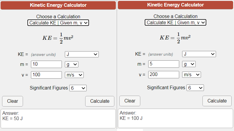

With the same propellant, although the momentum is the same for a lighter and a heavier bullet (##p=mv##), a lighter bullet at a higher speed has more kinetic energy than a heavier bullet at a lower speed (##KE = \frac 1 2 m v^2##).
  • Skeptical
Likes nasu
Here's an example:
10g bullet at 100 m/s: ##\mathtt{KE= 50J}##
5g bullet at 200 m/s: ##\mathtt{KE= 100J}##
From https://www.calculatorsoup.com/calculators/physics/kinetic.php:
