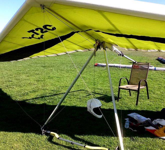

Easily solved with a wire or rope supporting my helmet. This is not my rig, but you get the idea...
On a different aircraft a chin rest could work.
