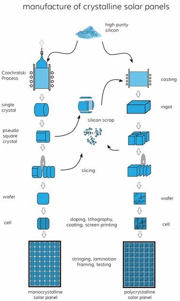

Why do monocrystalline solar cells have rounded/cropped edges?
Monocrystalline solar cells have rounded or cropped edges primarily due to the manufacturing process, which involves cutting from a cylindrical boule. Historically, circular solar cells were used, but square shapes are now preferred because they pack more efficiently in solar panels. The rectangular shape of individual cells allows for better space utilization and reduces wasted area. Additionally, the outer regions of the boule tend to form polycrystalline structures, making monocrystalline cells more desirable for their efficiency. The evolution in design reflects both practical and performance considerations in solar technology.

Why do monocrystalline solar cells have rounded/cropped edges? And why do solar cells need to be square-shaped in general?
No equations
There were circular solar cells 30 years ago. Why do we have square-shaped solar cells now? Why square now?
Rectangles pack better than circles. Seems that individual cells also assume a rectangular shape. .
Way I understand it, the outside of the boule tends towards polycrystalline formation (mono is preferable).
