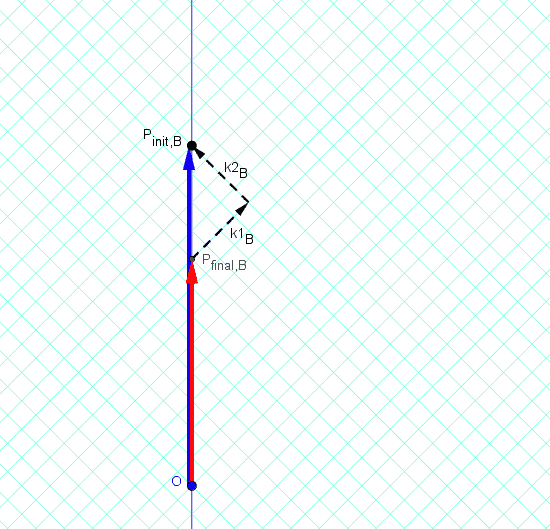

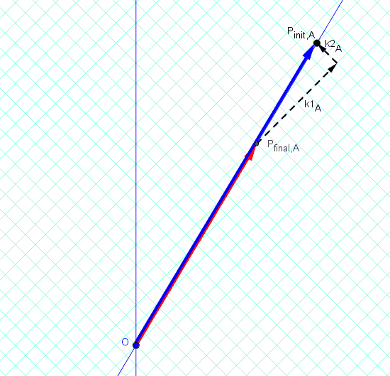

Along the lines of @PAllen 's comment, here are some energy-momentum diagrams of photons in different frames of reference.
(These were taken from my post to a different question on another site https://physics.stackexchange.com/questions/362125/momentum-conservation-with-photons/363478#363478 )
In the rest frame of the source, light signals of the same frequency are emitted in the forward and backward direction.
(The original question I responded to asked about the velocity of the source after emission.)
The diagram visualizes the conserveration of 4-momentum problem:
\tilde P_{fin}+\tilde {k_1}+\tilde {k_2}=\tilde P_{init}
in the rest frame of the source,
and in the lab frame [which observes the source moving].
Note, in the lab frame,
the forward light-signal's 4-momentum is increased
(compared to that signal's 4 momentum in the rest frame)
and the backward light-signal's 4-momentum decreased (similarly).
Thus, in the lab frame, the light-signals have different frequencies.

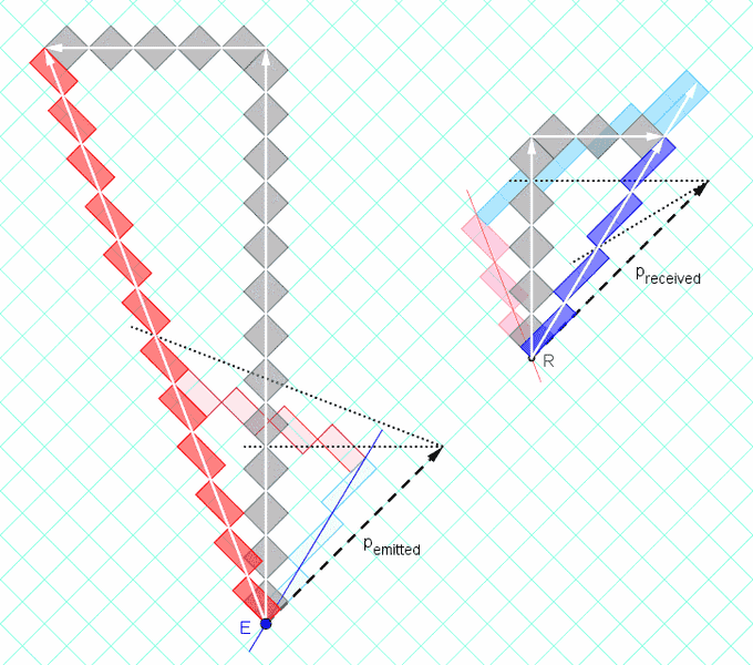

Hopefully this diagram will help clarify what many of us have been trying to say.
These diagrams are doing double duty as a spacetime diagram and as energy-momentum diagrams.
We draw these diagrams on rotated graph paper
to help visualize the light-signals and to visualize the unit tickmarks on observer worldlines.
The key idea is that:
once the light-signal with 4-momentum pemitted is emitted by the instantaneous emitter at E,
it travels along to event R on E's future light-cone along the direction of pemitted.
The emitter had influence on this 4-momentum only at E---what the emitted did before or after E doesn't matter.
The 4-momentum of the light-signal arrives at event R (call it preceived)
and can be measured by a instantaneous receiver at event R.
What the receiver did before R or does after R doesn't affect that measurement at R.
[Of course, since R and E are lightlike related,
there is no frame of reference where R and E are simultaneous... and
there is no frame of reference that can visit both R and E.]
For completeness...
In the emission diagram,
the source is moving with velocity [itex]v_{emitter,lab}=-5/13[/itex] and emits a forward light-signal [with velocity +c] with energy=6.
The lab frame measures that energy to be 4 units (thus redshifted).
Indeed [itex]k_{emitter,lab}=\sqrt{\frac{1+v_{emitter,lab}}{1-v_{emitter,lab}}}=\sqrt{\frac{1+(-5/13)}{1-(-5/13)}}=\frac{2}{3}[/itex].
In the reception diagram,
the lab frame would still measure that energy to be 4 units (no Doppler shift).
Since the receiver is moving with velocity [itex]v_{receiver,lab}=3/5[/itex], the receiver would measure energy=2.
Indeed [itex]k_{receiver,lab}=\sqrt{\frac{1+v_{receiver,lab}}{1-v_{receiver,lab}}}=\sqrt{\frac{1+(3/5)}{1-(3/5)}}=2[/itex].
From the emitter frame,
[itex]v_{receiver,emitter}=4/5[/itex] (check: [itex]v_{re,em}=\frac{v_{re,lab}-v_{em,lab}}{1-v_{re,lab}v_{em,lab}}=\frac{(3/5)-(-5/13)}{1-(3/5)(-5/13)}=4/5[/itex])
so, the relative-doppler factor is
[itex]k_{re,em}=\sqrt{\frac{1+v_{re,em}}{1-v_{re,em}}}=\sqrt{\frac{1+(4/5)}{1-(4/5)}}=3[/itex]. (check: [itex]k_{re,em}=\frac{k_{re,lab}}{k_{em,lab}}=\frac{(2)}{(2/3)}=3[/itex]).
From the receiver frame,
[itex]v_{em,re}=(-v_{re,em})=-4/5[/itex]
and [itex]k_{em,re}=(1/k_{re,em})=1/3[/itex].
This explains the received redshifted light-signal of energy 2, compared to the emitted energy 6.
