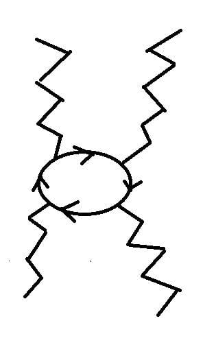

It's not entirely true that the electromagnetic field doesn't interact with itself. It's true on the classical level provided you insist on Dyson renormalizability for QED, because there's no way to write down a four-photon interaction term in the Lagrangian which is gauge invariant without involving derivatives, and the allowed ones all involve coupling constants of mass dimensions less than 0 and thus are superficially non-renormalizable.
Now in usual QED, i.e., the theory with a charged Dirac fermion (electrons and positrons in atomic physics) there are the "box diagrams" providing a four-photon vertex. This consist of four external photon lines with four fermion lines making up a loop (usually drawn as a square, that's why the diagrams are called box diagrams). Alltogether there are 6 such diagrams, contributing to the four-photon vertex, and all 6 must be taken together to get a useful result.
The important thing is that each of the diagram is superficially divergent with superficial degree of divergence 0 (logarithmically divergent). If this was really the case then QED would be non-renormalizable, because you'd need a counter term in the Lagrangian of precisely the forbidden gauge dependent form. Fortunately gauge symmetry provides strong constraints on the proper vertex functions, the socalled Ward-Takahashi identities, and these tell you that the four-photon vertex is in fact convergent, i.e., the forbidden couplings are strictly 0. So there is indeed a finite four-photon vertex, implying that there is photon-photon scattering, but it's awfully small since there are four vertices in these diagrams and thus the cross section is of order ##\alpha_{\text{em}}^4##.

Caution: QED is nonlinear; therefore two 1-photon states interact through higher order processes (e.g., exchange of a virtual electron-positron pair).
Only the equations for electrodynamics with a classical external current are linear.
Likes bhobba
I was using the word "linear" in a more restricted sense. The "bare" QED Lagrangian is linear in the sense that its only interaction term ##\bar{\psi} \gamma^\mu A_\mu \psi## just has one power of the EM field ##A_\mu##. In other words, there are no first order two-photon processes, i.e., no vertex where multiple photon lines meet.
But there are, as you note, nonzero contributions to the photon-photon scattering amplitude from higher-order processes; the diagrams for these processes involve multiple vertices, at each of which there is just one photon line. (@vanhees71 made a similar point in post #3; as he notes, the actual amplitude for photon-photon scattering, taking into account all of the higher order processes, is very small.) I agree, in the light of both of your posts, that QED is nonlinear in this sense, and that this sense of "linear" vs. "nonlinear" is more appropriate for this thread.

If you take into account quantum mechanics, isn't it the case that photons do interact, weakly? (By "weakly" I don't mean via the weak interaction, but not very strong...) The Feynman diagrams for two photons includes processes like this:
