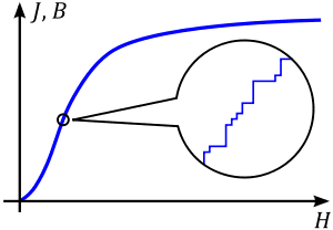

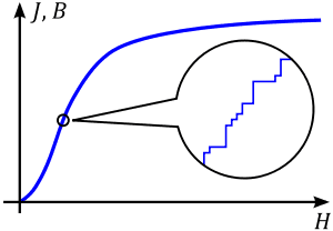

I was always fascinated by the idea of Barkhausen effect
and have long wondered if some similar phenomenon exists for conduction in metals.
I think one does.
Here's a couple of interesting articles on electrical noise that, i think, touch on your questions.
http://in4.iue.tuwien.ac.at/pdfs/iwce/iwce3_1994/pdfs/pp029-032.pdf
http://users.ece.gatech.edu/phasler/Courses/ECE6414/Unit1/Rahul_noise01.pdf
The myriads of random events that happen at microscopic scales cause fluctuations in the values of macroscopic variables such as voltage, current, and charge. These fluctuations are referred to as noise.
We've got meters nowadays so much more sensitive than those available to the pioneers we can measure things they could only dream of. So it becomes possible to study microscopic effects.
