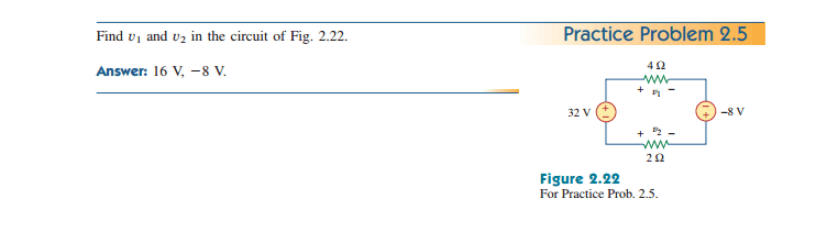

When I took intro physics, resistors didn't have polarity.
Now, in electrical circuits class, we start seeing resistors with polarity.
For example, this diagram in our textbook:
My professor insist that this problem had a misprint/typo: the polarity on the 2 ohm resistor should be reversed because "the current flow cannot go backwards when it reaches the 2 ohm resistor".
My questions are
1) why did the textbook bother showing the polarity of the resistors if it wasn't possible to have the arrangement of this diagram?
2) if my professor is wrong, and the book is correct, In this case, is one of the resistors resisting the current flow and the other resistor is "un-resisting" the current flow (ie: "speeding up" the flow)?
Your professor is right. The polarity of resistor simply indicates the direction of current through it, which is from + to -.

Do the +/- signs indicate the orientation of the measured voltages v1, v2 (akin to the choosing the arrowhead to indicate the positive x-axis)?

It's not the polarity of the resistors. The signs indicate the how the potential drops are defined.
I wouldn't say the book is wrong or that it's a typo. The voltage v2 is simply going to be negative because of the way it's defined.

Maybe this is a better way to describe what I think the notation means:
Clarifying earlier posts...
it's not about the polarities of the resistors
but the polarities of the voltmeters whose readouts are then assigned to variables v1, v2, etc

Your professor apparently doesn't know basic circuit theory. It's like @vela wrote, the polarities of the resistors aren't those of the actual elements in the circuit. They're the reference polarities of the variables v1 and v2.
Let's say you didn't show a polarity for v1, but you just wrote v1 over the resistor without any reference polarity. If I told you v1 was some positive value, would that mean the left terminal of the resistor was at a higher potential than the right? Would it mean the opposite? The reference polarity makes it unambiguous.
The references might look goofy to you since you have some intuition about the current direction in the circuit, but they're still perfectly valid. As you start learning circuit theory, you'll see a bunch of these types of circuits, where everything seems turned around, precisely to teach you to think in more abstract terms, which will help you avoid mistakes when trying to solve complex circuits.
If you solve the circuit, v1 will be positive and v2 will be negative with the current going clockwise around the circuit, so both resistors will consume power, as passive devices must.

since some of you guys wanted to see the question
from Fundamentals of Electric Circuits (5th ed)
The textbook answers confirm that the diagram is quite correct, there are no mistakes in the labelling. So when you clip a voltmeter across either resistor by attaching the voltmeter's red probe to the + resistor label and the black probe to the resistor's - label, the voltmeter will give the reading (and associated polarity) as in the textbook answers.
So your professor's claim is disproved.
If you were to swap the + and - signs on either resistor, you will need to amend the textbook's answer by changing its sign.

my professor swapped the signs of the 2 ohm resistor, and the answers he got were both positive : 16 V and 8 V
Sure, he can certainly alter any textbook question or diagram if he wishes.

so basically, the polarities of the resistors are only important when using Kirchhoff's laws? (separating the circuit into loops)
Resistors don't have polarities. The + and - signs refer to the voltage drop across them in the circuit. If you turn a resistor around they don't move.

The reference polarities are always arbitrary. As an example, here's your circuit with some references assigned that I just picked out to personal taste (you can pick them completely at random if you so choose):
KVL going clockwise with voltage drops counted positive:
$$-v_a + v_b + v_c + v_d = 0, \quad (1)$$
The element law for the resistor is (passive sign convention):
$$v = Ri$$
The solution to this equation is only correct if you have the reference current going into the positive end of the polarity of the reference voltage. You must never, ever apply it otherwise.
You have then:
v_b = R_1 i \quad (2)\\
v_d = R_2 i \quad (3)
The solution to the system of ##(1),(2),(3)## always gives correct results. You just have to figure out what ##v_a,v_b,v_c,v_d## are for your particular circuit. In your case, they're:
v_a = 32\,\mathrm{V}, v_b = v_1, v_c = 8\,\mathrm{V}, v_d = -v_2
