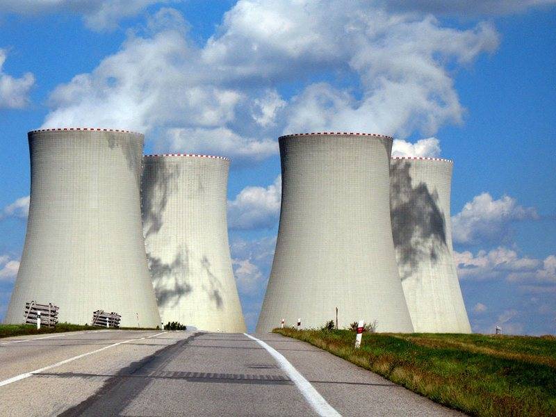

Alw is correct. It is just convection:
Some people even make mini cooling towers with shower heads:
http://www.overclockers.com/nuclear-tower-water-cooling/
