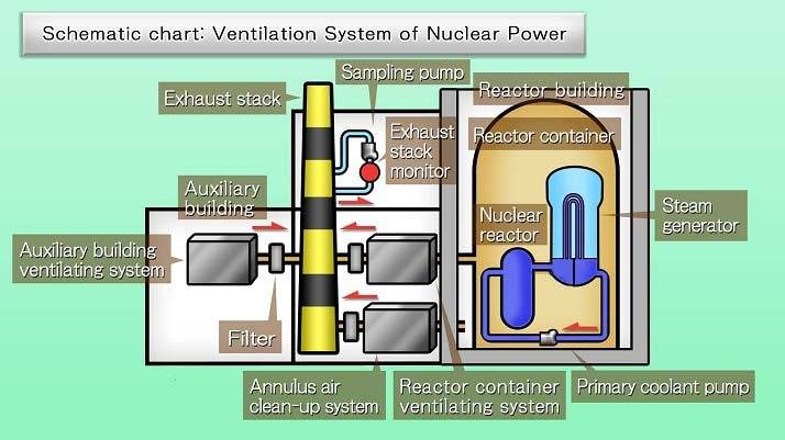

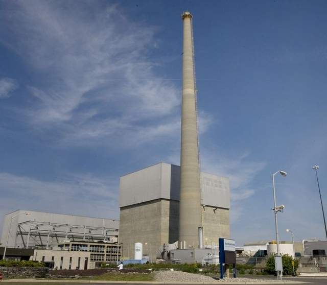

There are a lot of nuclear power plants around the world that have smoke stacks, the kind you'd usually see at a coal fired power plant. Are they to release steam in an emergency, or are they some kind of exhaust system the plant uses, or something else? Most nuclear power plants in America have them, and mostly all of them in Russia have them aswell. What are they for? Picture below
No=311130064&Ref=AR&MaxW=640&Border=0&NRC-reviews-Lacey-s-Oyster-Creek-nuclear-plant-after-Sandy.jpg
I'm pretty sure that their only purpose is to release unwanted heat from the coolent system after the superheated steam coming from the reactor has done it's job of spinning the generators.

I think those are for releasing non-condensable noble gasses. I believe the reason why some plants have them but not others may be due to the proximity to populated areas although it may be just a difference in design of different plants.
The cooling tower should be the rectangular building to the rear.
But indian point nuclear power plant, which is very very VERY close to New york, has one of these smoke stacks aswell. But if true, where do these noble gasses come from?
Any chance that is not the building housing the diesel emergency generator system for the nuclear plant.

Plants which are near populated areas need stacks to release the gasses high up so they spread out quickly and don't come back down over people. Plants in remote areas don't have that concern since there is no large population center to worry about. Note Indian Point is 40 miles away from NYC.
The gasses come from radioactive byproducts in the reactor coolant system. The gasses are stored temporarily in a tank until they decay into non-radioactive gasses, and then are released.
[separate post]
That is my interpretation as well.

I'm pretty sure all plants have a vent stack. At least all the plants I've been to had them. Sometimes they go up the side of the containment structure so you may not notice them unless you look hard. The ventilation system in the auxiliary building (PWR) gets filtered and released thru the stack; some plants have a small vent line on containment (to relieve the build-up of instrument air inside the can) - that goes to the stack as well. As someone said, during normal operation there is typically some small leakage of one kind or another. The stack is monitored and the releases logged and reported as required by the regulations I linked to above. The dose limits are something like 10 mrem (0.1 Sv) per year at the fence (I admit, I didn't read the current Regs and it has been a long time since I last read these).
That stack is an elevated release point.
If a gaseous release is required post accident, an elevated release point results in lower impact to the public down wind, as well as lower impact on site.
A gaseous release stack is not required, but it is one way to ensure compliance with 10CFR100 requirements post accident.
10CFR20 does not apply for nuclear accidents. The 10CFR100 and 10CFR50.62 requirements are used instead.
For BWR plants, like the one pictured above, this stack is the exhaust point for normal and standby gas treatment systems. The design of the BWR containment system involves a primary and secondary containment. The primary containment has an allowable leakage rate, known as La (or L-Sub-A), for leakage allowable. This is a tech spec (operating license) limit.
Any leakage from the primary containment can either go into secondary containment (the reactor building), or outside. All leakage must be quantified. Any leakage outside of secondary containment is considered "secondary containment bypass leakage", and is only allowed to be a small fraction of your total La. This is considered a direct ground level release during any accident scenario.
The remaining leakage goes into secondary containment. The secondary containment (reactor building for most plants) has a slight vacuum (0.25 to 1.25" of water vacuum) drawn on it by the standby gas treatment system. SBGT uses a combination of HEPA and charcoal filters to minimize gaseous releases, while also ensuring any releases that do occur are monitored, and pass through the stack (whether it's an elevated stack or not). Not all plants have elevated stacks, so any releases from their "lower" stacks is considered a ground level release as well, but as I said, it's all based on your 10CFR100 or 10CFR50.62 limits. If your population around the plant is low enough, you don't need an elevated release point. A plant like Columbia Generation Station has a stack that is nearly impossible to see because it doesn't go higher than the reactor building and is painted to look just like the building, all their releases are considered ground level, but they are on the Hanford Site so population really isn't a concern.
The standby gas treatment system will automatically start on any reactor building isolation signal. Typically this is high rads in the exhaust stack, level 2 reactor water level and lowering, high drywell pressure, high rads in the reactor building ventiliation system or near the spent fuel pool. When SBGT auto starts, it also automatically isolates the normal ventilation system.
A quick side note, vacuum in the reactor building is a tech spec requirement, and is also an Emergency operating procedure entry condition for the secondary containment EOP. If vacuum degrades, you enter the tech spec and secondary containment becomes inoperable. If pressure goes positive, you now have a potentially unmonitored release, and you enter the EOP to restore vacuum.
These stacks are also used for containment venting, although that wasn't their original purpose.
Hope this helps!

Isn't the schematic provided by the OP that of a PWR?

from: http://www.nrc.gov/about-nrc/radiation/related-info/faq.html#9
I found,
What kind and how much radiation is produced by a nuclear power plant?
An operating nuclear power plant produces very small amounts of radioactive gases and liquids, as well as small amounts of direct radiation. If you lived within 50 miles of a nuclear power plant, you would receive an average radiation dose of about 0.01 millirem per year. To put this in perspective, the average person in the United States receives an exposure of 300 millirem per year from natural background sources of radiation.
