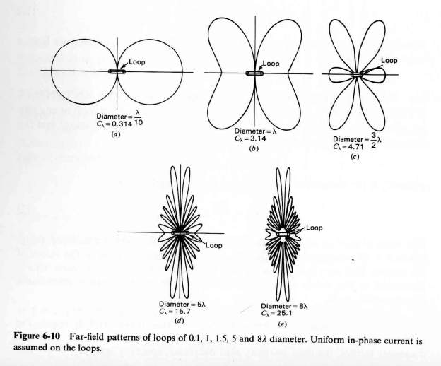

Why do these antennas have different radiation patterns?
In summary, the different antenna radiation patterns are due to the different spacing of voltage and current points around the circumference of the loop.

In Kraus book on antenna (3ed page 203)
example 7-4.1
the difference between those antenna is (to my understanding) only the wave length.
How could they have different radiation pattern?

From page 248
Stephen Tashi said:
From page 248
yes, thanks. but
Why does an antenna has different radiation pattern at different wave-length?

A small loop may be regarded as two closely spaced rod antennas driven in anti-phase. This applies when looking from any direction in the plane of the loop. It occurs because there is no phase shift around the loop, because it is small compared with the wavelength, and the rods are being driven at opposite ends.
As the wavelength is reduced, there starts to be a phase difference between the two antennas, and the various patterns are simply the array factor of two antennas having the particular phase and spacing. For instance, when the circumference becomes a full wavelength, the two antennas become in-phase and radiation is then broadside to the plane of the loop. I can explain this in more detail if wanted.
The radiation from all antennas is fundamentally caused by the acceleration of charges in the conductor. This also applies to loop antennas. From memory, Kraus does not use this approach, whilst Terman does.

Is there a confusion here? The antennas in the illustration are operating at the same wavelength but they have different diameters.
My slight error. I think we mean loop diameter, which is equivalent to altering the wavelength.
Likes davenn
where the diameters are different portions or multiples of the (fixed) operating freq and are expressed in wavelengths or parts there of, of that frequency
The diameter of the loop doesn't matter, by itself, but the circumference does and this depends on the diameter.
As you go around the circumference of a loop which is resonant, you would observe a standing wave pattern with alternate high and low voltage and current points.
This spacing of voltage and current points will vary with frequency.
It is the way that these are spaced that affects the radiation pattern.
In some directions, the resultant radiation will cancel due to the source radiations being out of phase with each other.
In other directions, the radiation will be in phase and the radiation will be enhanced.
