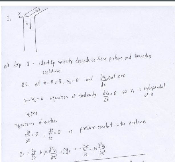

Why do we assume rho*gz=0 in the Navier-Stokes equations?
In summary, The equations of motion in terms of tau's won't allow you to easily solve for the velocities in complicated problems. And they don't directly take into account the viscous behavior of the fluid.
williamcarter
153
Navier-Stokes equations of motion

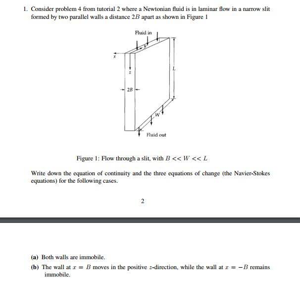

I did everything well but, my question is, why we assume last term rho*gz=0? in the N-S equation?
Also why do we use Navier Stokes equations in terms of velocity gradients for Newtonian fluid with constants rho and mu, and not Navier Stokes in terms of Tau?
When to use Navier Stokes in terms of Tau, and when to use Navier Stokes in terms of Rho and Mu?
They are defining P as ##P=p-\rho g_zz## to simplify the equation.

Thank you for your reply, I have 2 questions if you don't mind
1)why ρgz=0? on the right hand size, what is the phenomena behind, so they make that assumption
2) On the left hand side on the Navier Stokes equation for z component in terms of velocity gradients with constant ρ and μ, I don't get why they make all the left hand side terms=0?.
Like everything on the left side=0. I thought δVz / δx different from 0. I knew that Vz(x), so it should not be 0. Also what happens with ρ term on left hand side in Navier Stokes, is it also =0?

Who says it was taken to be zero? What does the equation I wrote mean to you.
2) On the left hand side on the Navier Stokes equation for z component in terms of velocity gradients with constant ρ and μ, I don't get why they make all the left hand side terms=0?. Like everything on the left side=0.
The flow is assumed to be occurring at a constant downward velocity with a balance between viscous drag, gravitiational forces, and pressure forces.
If is different from zero. What is zero are the velocities in the x and y directions, the derivative of Vz with respect to z, and the derivative of Vz with respect to time.

1)P=p-ρgz=p+ρgh, I saw that in the solution they cut out that term.
2)So how exactly does this affect the left hand side term, that it makes it =0? Means no accumulation?
Why instead of 0=right hand side, why is it not ρ*δVz / δx= right hand side
3)I understood that δVz / δx ≠0 and the rest are 0 but , why does it not stay there then, on the left side if it is ≠0?

What do you mean that they cut out that term? The equation they were solving was: $$0=-\frac{dP}{dz}+\frac{d^2 v_z}{dx^2}$$ where $$P=p-\rho g z$$In this way the analysis automatically includes a pressure gradient in the z direction, a downward gravitational force on the fluid, and/or a combination of both.
How can there be accumulation if the fluid is incompressible?
The term you are asking about is $$\rho v_x \frac{\partial v_z}{\partial x}$$This term is zero because ##v_x=0##
As I said, it is multiplied by ##v_x##, which is zero.
