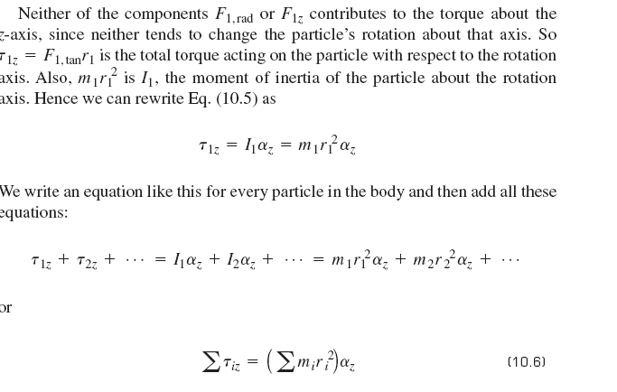

Oops, came up with a problem. As shown in the pic taken from University Physics below, we are counting torque on all of the particles of the rigid body, if there is no work done on other particles other than the point force is applied, how there is torque working on other points?? Torque derives from work, right??
Not a clear enough statement to be useful, imo. Torque is the cross product of force and distance from a chosen reference point; work is the dot product of force and distance moved by point of application of force.
Feynman chose to introduce torque via work. There's no compulsion to do so.
I re-iterate that the work done on the body is the sum of the work done by individual forces on it, and these are calculated 'locally' as described. That's not to deny that these forces affect the whole body, making it move, perhaps, by both rotation and translation, but that's nothing to do with how we calculate work done on the body.

I am kinda confused. If a single force is applied on a single point of an extended body, Does this force create torques in all points of the body about rotational center??
Hi,
first of all I'm not sure there are confusions with terms. Torque changes the rotational speed of a body, whereas m⋅r2 is the moment of inertia, which is more or less the resitance of a body against acceleration (or deceleration) in its rotational motion by torque. In your first post you wrote, that you want know the physical concept of torque like the laws of Newton for force. In fact you can compare them very easily:
F = m⋅a ⇔ T = I ⋅ α''
If you use the force F to accelerate a body, the size of the acceleration a depends on the mass m of the body - the larger the mass, the smaller the acceleration. The mass is the resistance of the body against beeing set in (linear) motion.
If you use the torque T to set a body rotating, the size of the rotational acceleration φ'' depends on the moment of inertia I of the body - the larger the moment of inertia, the smaller the acceleration. The moment of inertia is the resistance of the body against beeing set in rotation.
The parts of the formulas corrispond to each other
F ⇔ T
m ⇔ I
a ⇔ α''
The moment of inertia not only has to take in account the mass of the body which should be set rotating, but also the its distance from the rotational axis. You can think of that very easily if you compare two hollow cylinders (pipes) of the same mass and the same length, but with different diameters. You will need a higher torque to set the larger pipe rotating at the same speed in the same time, as the mass has to move faster to turn around one time when rotating. This moment of inertia is not as easy to find for a "natural" body (for simple bodies (spheres, cylinders, ...) you will find them and also can calculate them as mentioned in the text you posted - it's the some of all Δm⋅r2 in a body). Of course a certain torque will set rotating the whole rigid body, but its final rotational speed depends on its moment of inertia.
Now the torque itself is the (cross!) product of a force and the normal distance l (=length of lever) between the force and the rotational axis.
T = F⋅l
To calculate the torque there are several way:
1) You can measure the rotational speed φ' of the body and the time t you needed to accelerate it (assuming constant torque/acceleration).
α'' = α' / t
Knowing you have accelerated every point of the body (due to its rigidity), you can calculate the torque, if you know the momentum of inertia.
T = I ⋅α''
With this approach you found the torque "using" all the points set in motion.
2) The Torque itself comes from a force which not necesserily acts over the whole body, but maybe just in one point (like when you open a door, you only push the door knob not the whole surface of the door). This torque must be same as calculated in 1), but now with a different approach:
T = F⋅l
Now you don't need to know the speed of all points of the body, the force and the lever are sufficient for calculating the torque.
3) A third way would be the calculation with the help of the energy consistency (now I'm referreing to your first post: "... it isn't sufficient to write w=Fx.delx + Fy.dely. because all points of that rigid body moves as a result of this force.") The energy transferred in a body, which was rotated is
T⋅α = Wrot (compare for linear motion: F⋅s = Wlin )
Due to the energy consistency, the work done by the force F, must be the same as the energy input into the body.
Wrot = Wlin
T⋅α = F⋅s
T = F⋅s / α
So it is sufficient only to use the work done by the force and it's displacement to calculate the torque, if you know the angle α, which the body has rotated. Of course you could transfer it in a formula using all the moved mass points:
T = I⋅α''
F⋅s = I⋅α''⋅α = τ⋅α''

Since the force doesn't act on the other points, the integral over them would be zero.
No, the other points are accelerated by internal forces.
