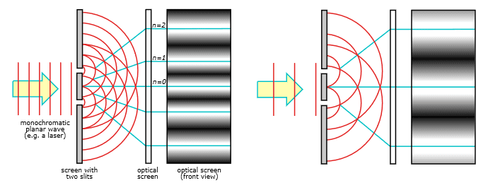

How do 2 waves in a double slit get cut? I know that light spreads in all directions so, when a double slit is infront of a light source, then it only allows light that goes through the slit past the wall. Why do interference patterns depend on the wavelength? Isnt the wave length perpendicular to the orientation of the slit? I would image the interference patters depend on the angle with which the light gets cut, but I don't see conceptually how it depends on the wavelengths. Can someone explain this conceptually?

The reason the interference works is that waves of the same wavelength, taking different paths, can add and cancel, depending on where they arrive. Wavelength and the spatial layout of the situation go together to produce an interference pattern.

I can explain it diagramatically:
Image adapted by Dr Greg from File:Two-Slit Experiment Light.svg, public domain.
I have a feeling that the real problem here is understanding the basic way waves work. (i.e. a couple of stages earlier)
