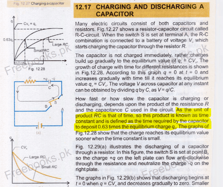

I am absolutely thankful for your time to address my query. What I meant from my question was how a capacitor knows it should charge to 63% of the equilibrium charge, not 70% or 80% or any other value. Please see the clipping I have attached if my question is still not clear.
High regards.
Zahid
It doesn’t “know” anything. The greater the resistance R the more slowly charge moves into the capacitor, the greater the capacitance the more charge needs to move, and when you work through the math you’ll see that these effects combine so that RC is the time it takes for the capacitor to reach 63%. If you increase R or C it will take the capacitor longer to charge to 63%, but the value of RC will also be greater to compensate.
And of course the capacitor doesn’t stop charging after time RC - it keeps on accepting more charge until eventually it reaches equilibrium.

My actual question is about the physical interpretation of this figure of 63%. Why does a capacitor follow this figure? May we explain it without going into the differential equations? Regards
Because of the mathematical relationship between R, C, and the rate at which charge flows into the capacitor.
May we change this definition and say time constant is the time in which a capacitor charges to 70% of its equilibrium charge.
You can if you like. Personally, I prefer τ = RC, but there's no reason you couldn't define τ = 1.2⋅RC.
I think you are missing the point with these questions. The equation for the solution is all you need to know.
