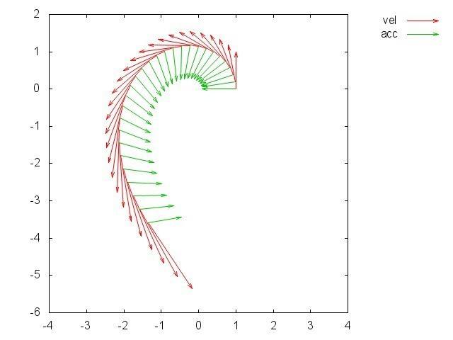

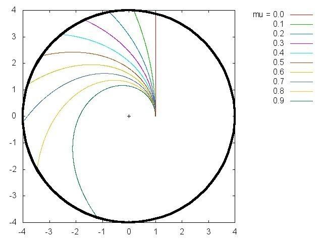

Suppose we place a coin on a non-rotating turntable and slowly increase the turntable's rotation rate. We'll stop increasing the rotation rate at the instant the coin starts slipping. I'll define μ (mu) as the ratio of kinetic friction to static friction, and set the axes such that at the instant the coin starts slipping, xhat points from the center of the turntable to the coin and yhat along the coin's inertial velocity vector. Below is a family of lab frame trajectories on the turntable that result from this:
Focusing on the mu=0.9 curve, here's a plot of the lab frame velocity and acceleration vectors at various points along the trajectory:
I generated the above using a python-based simulation and gnuplot. Here's the python script:

technician said:
PS your diagrams show it perfectly
Shows what perfectly? I don't know what you're seeing, but what I see is that the frictional force is not centripetal. The force vectors don't point to a common center and they are not normal to the velocity vector.
because you have friction acting over the whole table not just in a radial directio...that is what my ball bearing on a rotating table is to illustrate.
It looks to me as though you definately have a component of acceleration towards the centre
as well as a component 'tangential?'
Diagrams look ok for me.
Those two diagrams are very useful - especially the red / green vector one. The fact that the velocity vectors are increasing in length must imply that there is some tangential force component and that implies that the acceleration is not quite towards the centre of the curve at each point (i.e not quite normal).
@techncian: your comments still seem to imply that you are still seeing this from a bit 'off beam'. How can a force act "all over the table"? It can only act in one direction at a time and only at the point of contact with the coin. It would be easier if you tried to use less 'personalised' terms if you want to converse usefully on a topic. That's the way Science works best.
@DH It would be interesting to see how the rate of energy supplied (work done) by the motor increases as the path of the coin progresses. The forces increase and so does the speed.
I think we all agree! the only issue is about 'language' I write in the way I would talk to students watching me with the model...nothing wrong with that.
'all over the table'...OK...wherever the coin is on the table there is friction.
I (in my class) would like to 'remove'/'ignore' the 'tangential' friction which keeps the coin traveling along the circle... I want to try to show/talk about the friction responsible for keeping the coin in circular motion... I think these are 2 separate aspects of the friction...ω2r for the centripetal force... no idea what the other one is.
So... I think, regardless of language, we agree that
1) there is a force of friction between the coin and the table
2) the radial component of this friction force is the centripetal force
3)the 'tangential' component stops the table slipping under the coin
DH's diagrams illustrate this nicely...the green arrow is not at 90o to the red arrow, except near the start so the green arrow is the resultant of 2 friction forces.
My ball bearing demo on a rotating table effectively 'removes' the tangential component of friction. I also have a rotating railway track that does the same thing.
I am perfectly content with everything here.
PS...DH's diagrams are the closest anyone has come to showing what could be called 'free body diagrams' the diagrams I draw go well with these diagrams...it is a great pity more free body diagrams are not drawn to illustrate these problems.
The centripetal force is not "radial" unless the motion is in a circle about the turntable spindle (no slipping). The centre about which it is orbiting is not the spindle.
The tangential component speeds the coin up and the coin is slipping.
I hope you sort this out before confusing your students.
