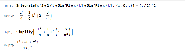

verify the uncertainty principle by wave function of infinite well free particle(ground state)
\sai(x)=\sqrt {2/L} sin(Pi*x/L)dx
So I think I use the right approach and I get uncertainty like this:
And it's interval irrelevant(ofc),
So what kind of wave function gives us \h_bar / 2 ? I guess a normal curve? if so, why is normal curve could be? if not then what's kind of wave function can reach the lower bound
Supplyment:
For <x^2>
for <x> it's simply L/2
for <p> it's simply 0
for <p^2> it's
by sin^2 integration.
