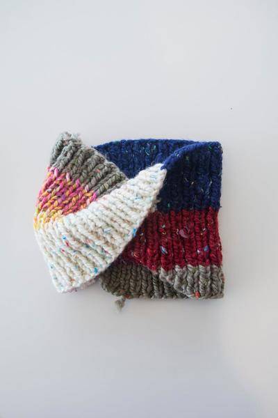

A recent article in Smithsonian magazine about knitting geometric forms stimulated the following question:
In the above, knitted Moebius strip, there are areas where the material is twisted (seen in front) and areas where the material is flatter/less twisted (seen in back). So far as I can tell, the same is always true for Moebius strips made from twisted paper. (The knitted form shown also has a kink in it, which a paper form will normally not have.)
This localization of the twist has also been found to occur in (both real and theoretically constructed) Moebius strips made of benzine or other chained molecules, which took the researchers investigating this phenomenon by surprise.
This raises for me the following questions:
1) Why, in all these physical situations, is the twist not evenly distributed along the strip?
2) Is a regular twist possible to achieve in any non-rigid material? (I specify non-rigid because it seems that one could cast such a thing in bronze or concrete, 3-D print such a form, or even construct one of superconducting materials...although even most such forms seem to have regions of greater and regions of lesser twist)

Image at, https://www.smithsonianmag.com/innovation/what-knitting-can-teach-you-about-math-180969637/

Using the knitted version as a model, consider this. The same situations apply to the others but it's easier to see with the knitted one.
  • Cut the knitted strip vertically, thru the Blue, Red and Gray stripes.
  • Lay the resulting strip flat on the table.
  • Now curl the ends around to meet; so it looks like a flattened donut.
You will find that the inner circumference will buckle into ripples, it will not lay flat. That's because the inner and outer edges are the same length but with the inner circumference being smaller that the outer circumference, the extra material has to go somewhere.
The same thing happens with the Mobius strip. It just turns out that the lowest energy configuration is for the 'extra material' on the edges to exchange places so that there is only one ripple. In fact, even the 'donut' may have only one ripple in it (you could flatten it though so there are many small ripples).
