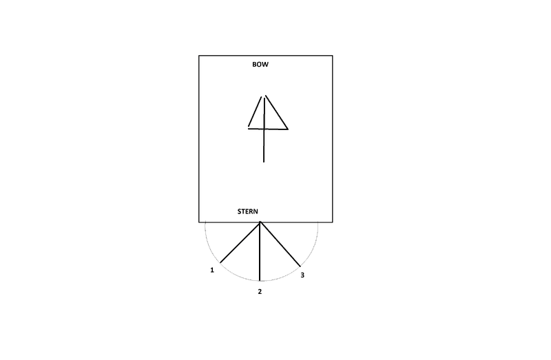

In small sailing boat like optimist is well know technique when there is no wind, rudder pumping which push boat forward.You just need push-pull rudder left to right with fast movement.
1) Rudder is stiff(not flexibile like flippers for diving),so why rudder produce forward thrust if high and low pressure around rudder switch each time when rudder passes center line position so thrust component of resultant force change direction from forward to backward all the time. From looking pressure distribution it seems boat must stay on place, thrust= zero.. Can you explain forward thrust with pressure distribution around rudder?
Please don't explain rudder thrust with Newton 3 law, rudder push water back-boat goes foward becuase, action-reaction is too simple and don't explain how pressures/net resultant force around rudder produce thrust.
2) If rudder is flexibile like flippers for diving, will it produce more thrust because and why? I think it will, because in every position of pumping reslutant force will point more forward..
Also what is ideal "pump angle"(angle from left to right swing) of rudder movement to produce max thrust?

Just because it is simple doesn’t mean that it is wrong, and in fact Newton’s third law is the answer: If water is pushed backwards the boat will be pushed forward.
Your diagram is confusing you because you’ve placed the pivot point in the center of the rudder. With that design we can see from symmetry that there will be no net movement of the water and hence no net force (note below). However that’s not how real boats (at least those that can be propelled by thrashing the rudder) are designed; with the rudder post off-center both the left and right strokes will displace water in the same direction to produce a net force.
(Note - the symmetry is not perfect unless the rudder post is also in the center of a symmetrical hull. I’m ignoring these hull effects because you’re not considering them either, and because they complicate the analysis without providing any additional insight into the physics involved)

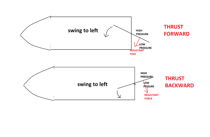

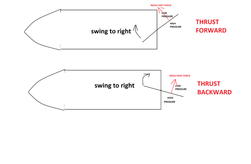

When rudder rotate when resultant froce point slightly forward(produce thrust), must be different pressure compare to part where resultant force point backward.Othervise boat will stay at place.
I can't find this pressure imbalance...that is point of question

When rudder rotate from 1 to 2 is pressure field at him 100% identical compare when rudder rotate from 2 to 3?
If yes, why boat move forward?
(For my logic from 1 to 2 rudder produce thrust, in position 2 thrust is zero, from 2 to 3 rudder produce force in backward direction/drag)
In position 2 thrust is zero, becuase pressure act prependicular to surface,so rudder here produce side force...

This is true, but must be some pressure imbalance to achieve that.
Action-reaction don't comes from nowhere, must be surfaces where this "force" act, boat is in fluid so we are talking about static pressures at rudder sides to explain net force which obviusly point slighlty forward and produce thrust that move boat forward.

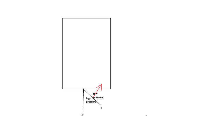

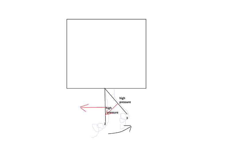

Rudder when moving from 2 to 3, where is high pressure side and where is net force pointing?
Do you agree with my pressures fields and resultant force?
(red arrow is resultant force)

Then you have an explanation for the forward thrust. Now the challenge is to apply that understanding in the inertial frame.
One thing to consider is the momentum of the water that you are deflecting. At the end of a stroke from 2 to 3 (as the rudder moves from center to the right and comes to a stop). You have this slug of water that is moving rightward. As you bring the rudder to a stop and then reverse, this slug of water is deflected rearward.
The key is that the water is not just a viscous medium that resists the rudder with a coefficient of drag. It has mass. You cannot just look at rudder velocity. You have to look at acceleration. Which is 90 degrees out of phase with velocity.
When moving from 2 to 3 the high pressure side is at the front of the rudder and there is a component of force that is slowing the boat down. However because the flow is (more) laminar than it is when moving from 3 to 2 the pressure differential is less and so this slowing down force when moving from 2 to 3 is less than the speeding up force when moving back quickly from 3 to 2.

Look at my post 18, I can't understand how rudder produce thrust when moving from 2 to 3 because pressure fileds don't allow that..
Please talk with pressures not action-reaction.
Action reaction is explantion for kids, don't tell nothing.
It doesn't produce (rearward) thrust, look at my post #20.
So we all agree that rudder produce drag(even if push water backward) from 2 to 3 ?
Yes of course it produces drag, and it doesn't push water backward from 2 to 3 (water is allowed to flow backward in this stage).

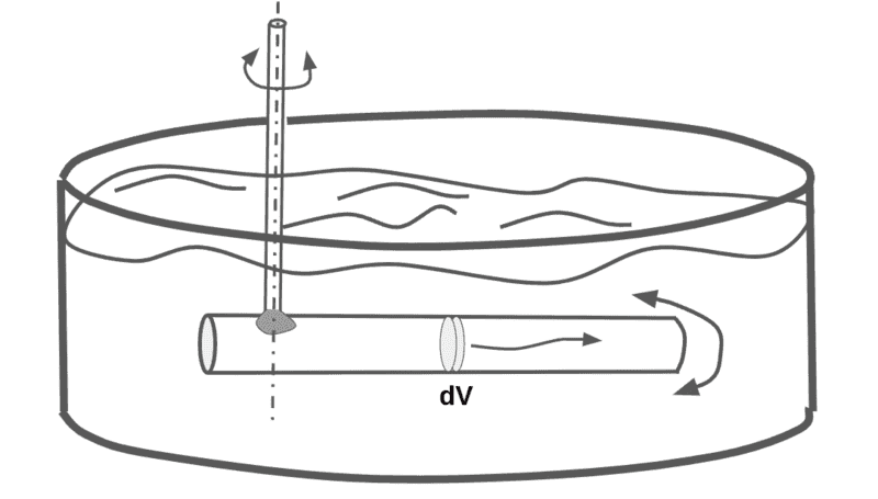

Here is a simplified situation that (I hope) contains the essential features of the rudder case, capturing what jbriggs444 says. We have a tube immersed in water and "wagged" around an axis near one end.
In jbriggs' view, when the tube changes direction (either from CW to CCW or from CCW to CW) the water in the tube exerts a reactive force on the wall, which has a "boatward" component during both changes of direction.
This makes sense to me as one possible contributing factor -- but is it the only source of an average push driving the water along the tube?
If we rotate the tube uniformly in one direction, say CW, the above mechanism would be out of action. But I'm guessing that centrifugal action would still propel the water through the tube.
But even as I was composing this post (hoping to prove that centrifugal effects also contribute to propulsion), I realized that the centrifugal ejection of water would not result in an opposite backward reaction, because that is just the water "refusing" to be accelerated along a circle and "insisting" on moving along a tangential straight line -- so this can't contribute any propulsion to the boat!
