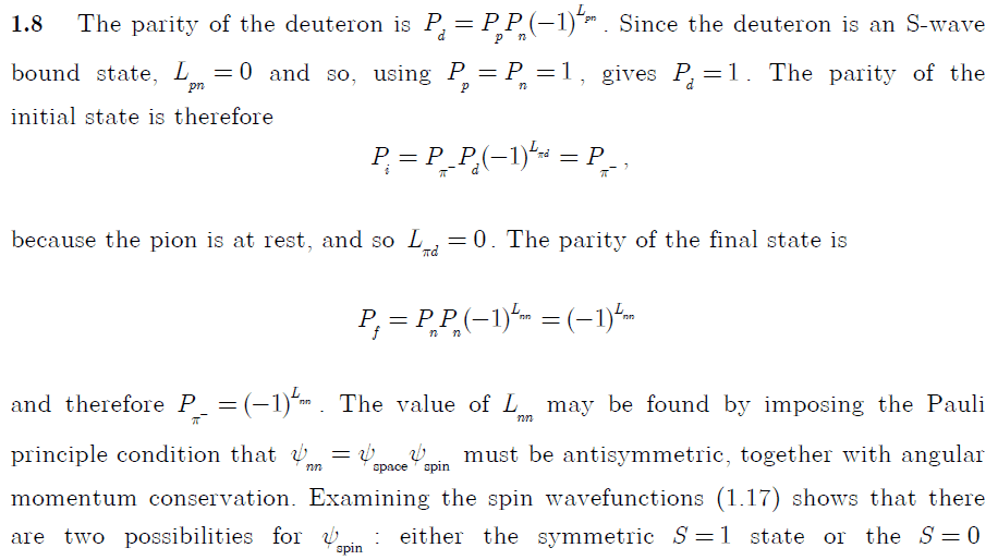

1.8 Consider the strong interaction ##\pi^{-} d \rightarrow n n,## where ##d## is a spin- 1 S-wave bound state of a proton and a neutron called the deuteron and the initial pion is at rest. Deduce the intrinsic parity of the negative pion.
$$\hat{P}\psi_{nlm}=p(-1)^l \psi_{nlm}$$
I looked in the instructor solutions, which are given by:
But I don't quite understand the solution, so I hope you can help me understand it.
First. Why do we even know we are working with wavefunctions with the quantum numbers n,l,m? Don't we only get these quantum numbers if the particles we're working with, is in a spherical symmetric potential?
So in other words, why do we need to consider the quantum number l (angular momentum)? Is that because strong force gives rise to a spherical potential?
When using the parity operator, why do we get the the combined angular momentum ##(-1)^{L_{\pi d}}## and not just: ##(-1)^{L_{\pi}}\cdot (-1)^{L_d}##. Can I always just couple the angular momentum when working with multiple particle wavefunctions, and assume operators only works on the coupled angular momentum?
The most important question, is how the angular momentum relates to the symmetry of a wave function.
Why does a symmetric space wavefunction ##\psi_{space}=symmetric## implies that the angular momentum ##L_{nn}## has to be even?
And the opposite. Why does an antisymmetric wavefunction imply uneven angular momentum?

The final state is two neutrons, so two identical fermions. By the Pauli principle, the total wave function must be anti-symmetric.

It's because of the parity of the spherical harmonics: ##\hat P Y_l^m(\theta,\phi) = Y_l^m(\pi-\theta,\phi+\pi) = (-1)^l Y_l^m(\theta,\phi)##.

The potential for the interaction depends on ##\lvert \vec r_1 - \vec r_2 \rvert##, so you can analyze the interaction in terms of the center of mass of the system and the relative position of the particles, ##\vec r = \vec r_1 - \vec r_2##. Exchanging identical particles then is the same as replacing ##\vec r## by ##-\vec r##. Hence, a symmetric wave function is one which is even parity, and an antisymmetric wave function is one that is odd parity.
Likes vanhees71
The last point is now to also take into account the spin state! In other words, think about what means that the d is a "1S bound state" concerning the symmetry properties of the spin?
