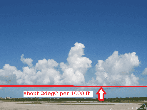

I grew up in South Florida, definitely Cumulus territory.
The height of the clouds tells a weatherman a lot.
When there's good mixing as in summertime, the height of their bottoms tells him the humidity.
(to be more accurate with my wording - it tells him the difference between ground air temperature and dewpoint, which is closely related to humidity).
Rising air cools about 2 degrees C per thousand feet.
When it cools to dewpoint the water begins to condense,
and when a seasoned forecaster was just starting out as a lowly observer tracking weather balloons he became good at estimating cloud heights
243445
(image courtesy NWS)
so if those cloud bottoms are say 2000 feet, it means dewpoint is about 4degC (7F) lower than surface temperature .
90F with dewpoint of 83 is a muggy Miami day.
