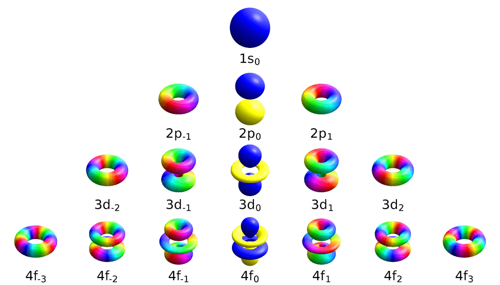

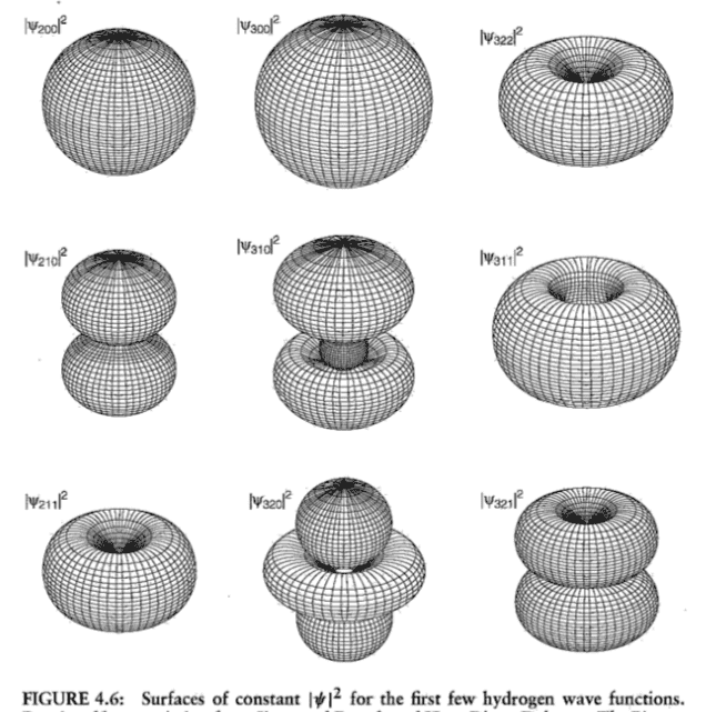

These are some electron orbitals.
Except for the first two, the rest are all not spherically symmetrical, hence a preferred z axis. This is unexpected since the potential energy function is perfectly spherically symmetrical.
For an isolated hydrogen atom, which direction (in the physical world) will turn out to be the preferred z axis?
The z axis is just a very human made convention. It has to do with humans and the fact that the "z" label is the one going up, if you allow me the metaphor. If the "right handed orthogonal system" had the x label going up, and z to the right, then angular momentum would have Lx wherever Lz is now used. Mathematics requires only one preferred direction (rotation axis in classical mechanics). By convention this the "up" one, which, by another convention, is called z.
Likes vanhees71
From the shapes of the orbitals, this mathematical choice of a z axis produces a physical effect: the orbitals is now symmetrical about this particular axis. But this is absurd.
Which physical direction would this z axis be? Are you saying it's random? That is, in an ensemble of isolated hydrogen atoms, some has their z axis pointing up, some right, some slanted to the left by some angle, etc.
And why is the spherical symmetry destroyed in the physical world?

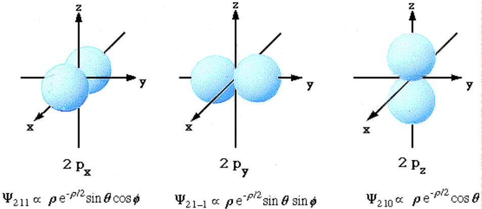

##p_x## and ##p_y## orbitals have their ##m## negative of each other, implying their ##L_z## are pointing in opposite directions. But I don't see how they are opposite from the diagram. How do you see it?
And the superposition of these 3 orbitals alone, exactly as they are shown in the diagram, doesn't give spherical symmetry right? Because it would give a higher probability along the 3 axes of the coordinate system. To produce spherical symmetry, we have to continue adding more triplets of orbitals (##p_x##, ##p_y## and ##p_z##) whose axes point in all other directions. Right?
Wrong. If you get the properly normalized wavefunctions (those you posted are not), add them and square them they will only be a function of r.

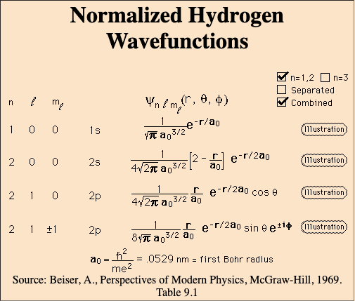

I still get an angular dependence: the result is proportional to ##(\sqrt{2}\cos\theta+2\sin\theta\cos\phi)^2##.
No, very obviously adding the squared modulus of the three orbitals you mention above removes any angular dependence.
Just for the record: Where did you get this picture from? It is completely wrong. The px, py and pz orbitals do NOT correspond to m=-1,0 and +1. The following image from wikipedia gives the orbitals corresponding to the different m states:
Note that only the p-orbital for m=0 looks like the ones you posted. So why is that the case? The orbitals are in principle complex functions. The value of the real part is given by the shape, while the colors indicate the imaginary part. As you can see, the m=0 orbital is already real, while the ones for m=-1 and +1 are not. In fact, they have a 2 pi rotation of the phase around the axis. As phase gradients are roughly representing the local wavevector, this is indicative of the orbital angular momentum.
However, in many situations you want real orbitals or ones with a directionality that matches the symmetry of your problem. This is how px, py and pz-orbitals come into play. If you build the two possible superpositions of the m=-1 and m=+1 modes, the corresponding superposition orbitals will be real. And they will look like px and py. These orbitals are great, e.g. for chemistry, where you may have a lattice and bonds predominantly form along the lattice directions. However, they do not represent the orbital angular momentum projections.
