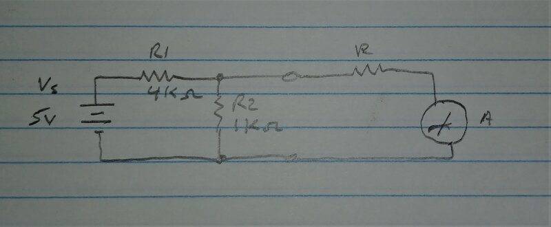

Consider this simple circuit, with the ammeter having zero resistance (not including R):
The voltage across R2 will be 1V when R=∞, or when the voltmeter is disconnected. The current through R1, I1=1mA.
But if R=1KΩ, then that would be the same as if R2=500Ω, in which case the voltage across R2 is 0.556V with the current through R1 being 1.11mA, equally divided between R2 and the meter.
Then in the extreme case of R=0, the voltage is 0V, the current through R1 is 1.25mA and it all flows through the meter.
