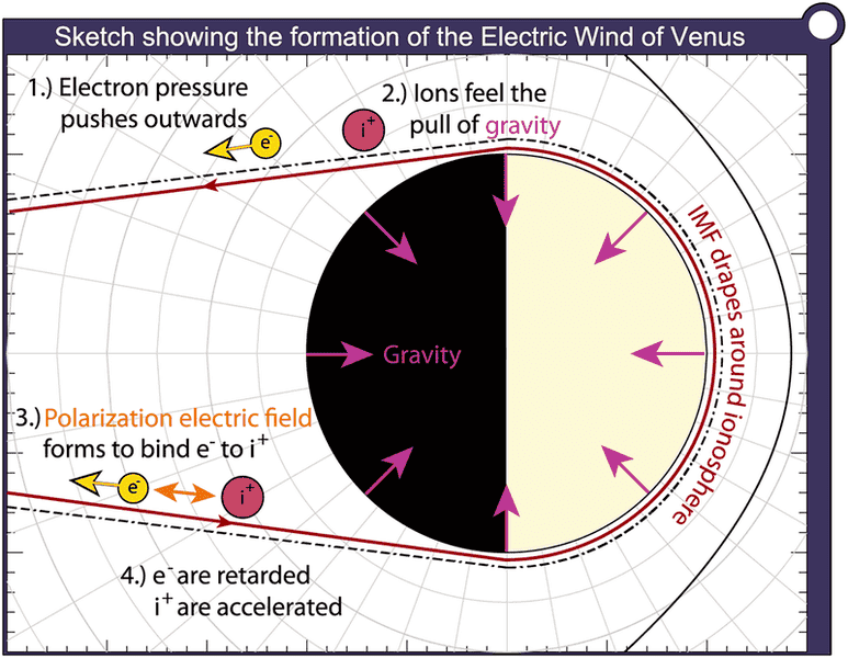

Venus is another good example. Surface winds on Venus are rather small compared to those on Earth. Things however get rather weird in Venus's upper atmosphere, which rotates much, much faster than does Venus itself.
We see this to a limited extent in the Earth's atmosphere. Like Venus, the Earth's upper atmosphere (i.e., above the stratosphere) rotates a bit faster than does the Earth. This is generally attributed to the upper atmosphere's diurnal bulge. Unlike Venus, the super-rotation of the upper atmosphere is rather small, perhaps 10 to 20 percent faster than the rotation rate of the Earth as a solid body.
Venus's rotation rate is so very slow that the concept of a diurnal bulge (as an explanatory mechanism) doesn't quite make sense. If you want to make a tiny dent in science, explaining Venus's weird atmosphere might be a good place to start. You'll need to fully understand atmospheric dynamics to do so, and if you gain this knowledge, this will put you on a footing with a number of very good scientists who are trying to explain Venus's weird rotation rate.

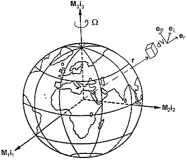

More data on Atmospheric Angular Momentum (AAM) and Length of Day (LOD)
http://onlinelibrary.wiley.com/doi/10.1029/2006RG000213/full
[2] Angular momentum characterizes the rotation of physical systems ranging from the atomic scale to galaxies. In particular, the global angular momentum M of the atmosphere reflects both the rotation tied to that of the Earth and rotation due to the winds. A wealth of data and theories is available to determine the distribution of angular momentum and to provide the reasons for its changes. Attention is restricted in this review to large-scale motions, although angular momentum is also of key importance, say, in hurricanes or tornadoes. The global atmospheric angular momentum is the integral
http://onlinelibrary.wiley.com/store/10.1029/2006RG000213/asset/equation/rog1654-math-0001.gif?v=1&t=ippj8s7t&s=2c2bab9f874ffdbedcaaf572f9d2096c39ec53ce
of the angular momentum
http://onlinelibrary.wiley.com/store/10.1029/2006RG000213/asset/equation/rog1654-math-0002.gif?v=1&t=ippj8s7t&s=518c5825d4839641914d971653bfaf4b0138cb78
per unit volume over the volume V of the Earth's atmosphere. In (2), r is the position vector pointing from the center of the Earth to the volume element dV of density ρ (see Figure 1). It is customary to assume a dry atmosphere because the contribution of the water substance to the total mass of the atmosphere is small. In principle, the density ρ in (2) also contains the water substance in all phases. The rotation of the Earth is represented by its angular velocity Ω with Ω = 2π/d. The relative velocity of the air with respect to this rotation is v and
http://onlinelibrary.wiley.com/store/10.1029/2006RG000213/asset/equation/rog1654-math-0003.gif?v=1&t=ippj8s7t&s=060425d355ced8d7b10839d0ee943b43171d0166
is the absolute velocity.
Figure 1.
Rotating Earth and the components Miii of the global angular momentum M in the rotating coordinate system with basic vectors ii. The position vector r points to a volume element dV in space, where the unit vectors eλ, eϕ, and er of the local rotating spherical coordinate system are defined.
