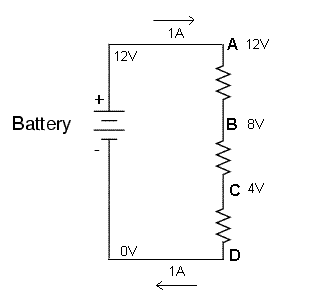

So if I understand correctly, voltage is the measure of potential energy when a circuit is open, correct? Potential as in, if the circuit were completed, that's how much energy is available to the circuit in total. Is that the idea?
not quite the potential between any 2 points in a circuit can be measured if the circuit is operating or directly across the battery even if the rest of the circuit is switched off ( disconnected)
look at this circuit I have drawn ...
we can measure the voltage directly across the battery and get 12V
negative (black) lead of meter on the bottom line 0V and the positive (red lead) on the top line
and measure 12V. or you could measure directly across any of the resistors and find the voltage drop across any of them. Or you could do what has been done in the circuit and measure from the 0V line and across the different points as shown

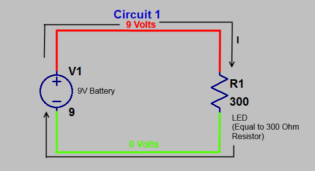

So now we understand the wire resistance. Let's do Ohm's law (V = IR). I'll draw out three of your circuits and calculate the current (I) and voltage (V) for each component and node in the circuit. Each node will be a solid color. Example, RED = 9 Volts at every point, Green = 0 Volts at every point.
Ohm's Law is quite simple:
[tex]V = I \times R[/tex]
or
[tex]Voltage = Current \times Resistance[/tex]
The unit of Voltage is Volts. The unit of Current is Amperes (Amps). The unit of Resistance is Ohms.
Okay, let's look at your first circuit with an ideal 9 Volt battery (ignoring the internal resistance for simplicity). The LED is represented as R1, a 300 Ohm Resistor.
We already know the voltage across R1: 9 Volts.
We also know the resistance of R1 since it's the equivalent of your LED: 300 Ohms
The only thing we need to calculate is the current going through R1.
Using Ohm's Law:
[tex]V = I \times R,[/tex]
[tex]9 = I \times 300,[/tex]
[tex]I= 0.03 \, Amps[/tex]
Pretty simple then. Your LED has 0.03 Amps going through it. That is what is necessary for the LED to produce light.

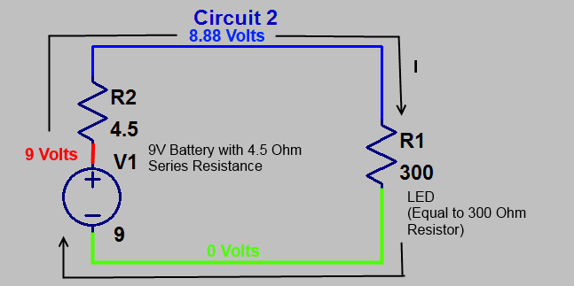

Next let's look at the exact same circuit except we'll treat the battery more realistically and give it an internal resistance of 4.5 Ohms. So the battery is now represented by V1 + R2.
Now we have two resistors in series (R2 & R1). Resistors in series can be added together to calculate the current (Current flows in a loop - the current through R2 must be the same as the current through R1). We want to see how much current is really going through the LED (R1) with a more realistic 9 Volt battery.
We know there is 9 Volts across R2+R1.
We know R2 = 4.5 Ohms.
We know R1 = 300 Ohms.
[tex]9 = I \times (4.5 + 300),[/tex]
[tex]9 = I \times 304.5,[/tex]
[tex]I= 0.0296 \, Amps[/tex]
So we see with a bit more realistic circuit, your LED has 0.0296 Amps going through it. Not too different from the ideal 9 Volt battery. We can also use this current to calculate the Voltage across the LED (R1).
[tex]V_{R1} = I \times R_{R1},[/tex]
[tex]V_{R1} = 0.0296 \times (300),[/tex]
[tex]V_{R1} = 8.88 \, Volts[/tex]
We can already see a little bit of a voltage drop when considering the battery's series resistance.

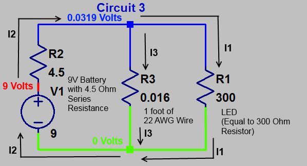

Last, we'll add the 22 AWG wire across the battery. The wire is shown as R3 with a resistance of 0.016 Ohms. In order to calculate the current through R1, we'll need to do some work with series resistors and parallel resistors. This is a bit more complex, but trust that we'll be getting correct numbers at the end (unless peers find errors in my math). I1 = [itex]I_{R1}[/itex], etc.
First we add R1 and R3 as parallel resistors to get an equivalent of the two:
[tex]{\frac{1}{R_{eq}}} = {\frac{1}{R1}}+{\frac{1}{R3}},[/tex]
[tex]{\frac{1}{R_{eq}}} = {\frac{1}{300}}+{\frac{1}{0.016}},[/tex]
[tex]R_{eq} = 0.015999 \, Ohms[/tex]
So [itex]R_{eq}[/itex] of R1 and R3 is just slightly smaller than R3. Now we need to add this to R2 in order to get the total equivalent resistance.
[tex]R_{tot}= R2+R_{eq},[/tex]
[tex]R_{tot}= 4.5+0.015999,[/tex]
[tex]R_{tot}= 4.515999,[/tex]
Then we can find the current through R2 (this is only the current through R2 since the current splits between R3 and R1 before returning to the battery and completing the loop).
[tex]V = I_{R2} \times R_{tot},[/tex]
[tex]9 = I_{R2} \times 4.515999,[/tex]
[tex]I_{R2}= 1.992915 \, Amps[/tex]
With the current going through R2 we can now use Ohm's Law again to find the voltage drop across R2. This will let us find the Voltage across R1 and R3 and then finally get the current through R1 (LED).
[tex]V_{R2} = I_{R2} \times R2,[/tex]
[tex]V_{R2} = 1.992915 \times 4.5,[/tex]
[tex]V_{R2}= 8.96812 \, Volts[/tex]
That's a hell of a voltage drop across R2. Remember R2 is the battery's series resistance. It's internal to the 9 Volt battery. The voltage you really end up seeing on the outside of the battery is:
[tex]V_{R1} = V - V_{R2},[/tex]
[tex]V_{R1} = 9 - 8.96812,[/tex]
[tex]V_{R1}= 0.03188\, Volts[/tex]
So the voltage across R1 (LED) is only 0.03188 Volts (The voltage across the wire R3 is the exact same as the voltage across R1, 0.03188 Volts. This is because they are both between the same nodes, or potentials).
Let's finish up with the current through R1:
[tex]V_{R1} = I_{R1} \times R1,[/tex]
[tex]0.03188 = I_{R1} \times 300,[/tex]
[tex]I_{R1}= 0.00010627 \, Amps[/tex]
The current through your LED is 0.00010627 Amps in this case (versus around 0.03 Amps when the LED produced light). Where's the rest of the current? Through the wire:
[tex]V_{R3} = I_{R3} \times R3,[/tex]
[tex]0.03188 = I_{R3} \times 0.016,[/tex]
[tex]I_{R3}= 1.9925 \, Amps[/tex]
If any of this is confusing, these search terms should help you find more explanation:

Kavik. Thank you so much. This really helped understand a lot. Just a few questions.
1. Why are you giving the LED a resistance of 300Ohms. I have two LED's. One has a resistor in it, but even that doesn't as 300Ohms on the multimeter.
2. How do you know the internal resistance of the battery?
3. When you show how to use the 0.0296Amps to calculate the Voltage across the LED, I get that you're showing what the voltage is pre-LED and post-LED (showing the delta voltage drop), but what's that little bit in between where you show 9V = I * 304.5Amps? I can calculate the 8.88V with just the 300Ohms of the LED and multiplying by the current of 0.0296Amps.
The LED plus internal resistor conducts a current of 30 mA when 9 volts is across it.
So it has a total resistance of 300 ohms.
9 volts / 0.03 amps = 300 ohms.
The internal resistance of the battery is derived from an earlier post (of mine) which assumed this value as typical for a 9 volt battery.
Since these two resistors are in series, as shown in the diagram, you add them up to get the total resistance of 304.5 ohms.
This then gives you the total current.
9 volts / 304.5 ohms = 0.02955 Amps or 29.55 mA.
The message here is that the effect of internal resistance is negligible in this case.
You can calculate the internal resistance of a battery if you measure its short circuit current.
If a 9 volt battery gave 1 amp into a near zero resistance load, (like an ammeter), it would have an internal resistance of 9 ohms.
9 volts / 1amp = 9 ohms.
The internal resistance of a dry cell battery is an indicator of the condition of the battery, as it gets greater with battery use.
