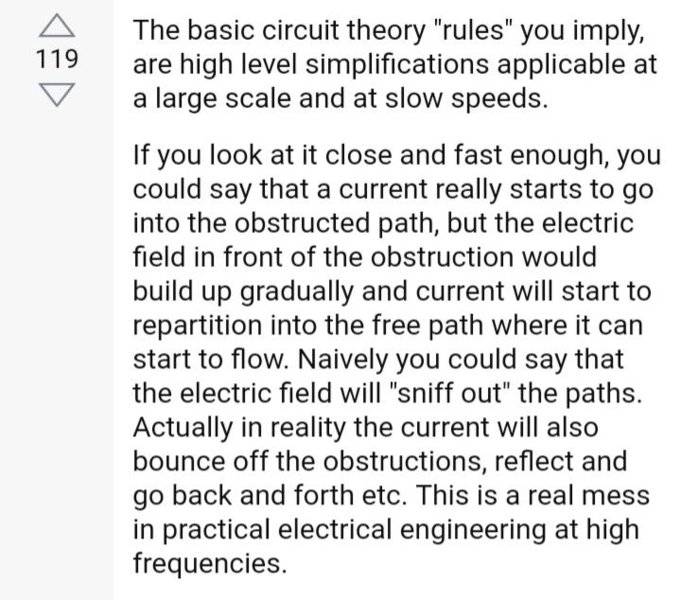

https://physics.stackexchange.com/a/437369/212048

what I don't understand is how the electrons even know which one has resistance and which one doesn't?
When the battery is first connected an electric field travels through the conducting paths at nearly the speed of light. The electrons respond to the field. They don't "know" anything. Humans taking measurements on a circuit might make the mistake of thinking the electrons use the same process as they do to determine the resistance of a path, but they don't.
