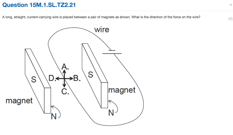

Hi! A long, straight, current-carrying wire is placed between a pair of magnets as shown. What is the direction of the force on the wire?
Fleming's hand rules
I used the Flemings right hand rule but that gives me that the force on wire is upwards. But the answer is otherwise. Thanks for your help!

You have to apply Fleming's Left hand rule to determine direction of force on current carrying wire .
