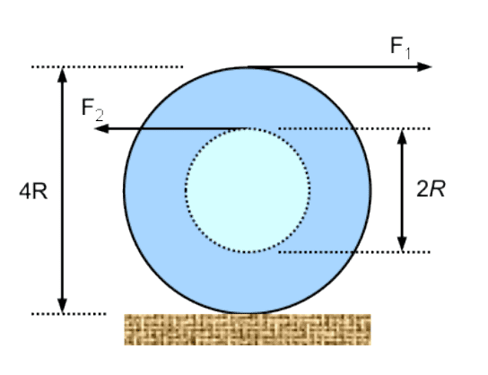

Here is a problem that I used to assign when I taught intro mechanics. A yo-yo is pulled by two strings exerting forces F1 and F2 as shown in the figure. The yo-yo is rolling without slipping at constant speed to the right. Find the direction and magnitude of the force of static friction given that F1 = 30 N.
10 N to the right.
It is not clear to me that the direction of static friction in this problem can be deduced a priori without at least doing some back of the envelope scribbling. Going the FBD route is an application of the principle that the force of static friction is "whatever is necessary to provide the observed acceleration but up to a certain point". It never fails and is easy to explain. That's my preference.

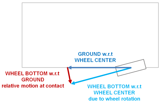

Vigorous said:
I can't grasp how from this friction will act radially inwards?
What static friction opposes is the relative motion at contact that would occur if there was no friction (marked red in the diagram).

Vigorous said:
Picture a runner in the right direction, let the runner plant his left foot on the floor, he is exerting a force down and backward on the floor, the left leg stays in contact with the floor for a few milliseconds, and the right leg is in mid air, after those milliseconds, the force exerted exceeds the maximum limit of static friction and slippage occurs. By Newtons third law, the ground exerts an equal and opposite force on the runner but do we identify this force as static or kinetic friction
You seem to be confused that friction is a reaction force to the force you apply to move any object. In fact it is not. It is a force that occurs due to electromagnetic interaction between the 2 surfaces in relative motion. In fact if you were to take an object to outer space and push it, it is not friction that is reacting to your push (because action reaction pair always act on different bodies) it the push of the object on you. You can see that you will be pushed backwards when you try to push the object forward in space. This can be recreated by standing on a roller skate and trying to push the wall, you seem to go backward even though you push the wall forward, this is the reaction force that the wall exerts on you when you exert a force on the wall.
Likes Vigorous
  • #35
As I turn the wheels to the left the wheels are pushing to the right against the floor. Friction allows the floor to push back against the wheels allowing them to turn left. If there was no friction then the object would fly off the circular trajectory and continue in the direction of the tangential velocity.
