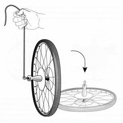

Here’s, specifically, how I’m stumped:
Take a toy gyroscope or equivalently a bicycle wheel gyroscope (I’m using both). Orientate the gyroscope so its axis of rotation is horizontal. Suspend one end of the axis by a rope, hold the other end of the axis with your hand – keeping it horizontal. Remove your hand, and of course the gyroscope falls and is left dangling on the rope with its axis now vertical. Now repeat with a spinning gyroscope. This time when you let go the gyroscope remains horizontal as it precesses. As framed by the following, WHY DOES A SPINNING GYROSCOPE LEVITATE?
For a non-spinning gyroscope…
Tension force from the string acts on one end of the wheel’s axis of rotation in the +y direction. A gravitational force acts on the COM in the –y direction. The negative y-forces are greater than the +y forces, as evidenced by the COM moving downward – thus the gyroscope flops over.
For a spinning gyroscope…
Same +y tension force, same –y gravitational force, but now there must be an additional +y force since the gyroscope exhibits no net vertical displacement, like it did when it was not spinning (its COM now remains in the same horizontal plane). Here’s the big question: what is the genesis of this new +y force? What gives rise to it in terms of underlying torques, torque arms, angular momentum, right-hand rules, cross products, etc., etc.
Thanks for any insight.
It doesn't levitate. The rope is holding it up. If you let go of the rope or cut it then the gyroscope will fall at 9.8 m/s^2.
Gyroscopes do not levitate. Unless you want to say "being held up by string" = "levitation", in which case everything levitates.
I suspect the people you mentioned were not stumped, but just trying to find a polite way to tell you that your question is counter factual.

Yes, I did. The tension in the rope is equal to the weight in the spinning case, so ##m a = \Sigma F = 0##. In the non-spinning case the tension is less than the weight so ## m a = \Sigma F < 0##.
There is no "new +y" force. There is simply a difference in the "+y tension force" between the two cases.

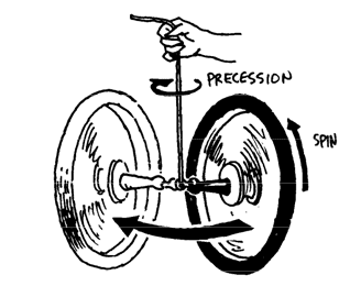

Why does a spinning gyroscope's axis (the other one being attached to a suspended string) remain horizontal, while one that isn't spinning flops over?
Since the gyroscope is supported at one end, it experiences a downwards torque due to gravity which effectively acts at the center of mass of the gyroscope. The reaction to the downward torque is a rotation about a near vertical axis, which generates an opposing torque to keep the gyroscope nearly horizontal. If the rotation is too slow, the gyroscope will tilt downwards. If the rotation is too fast, the gyroscope will tilt upwards. If the gyroscope is released at just the right rate of rotation, it will remain nearly horizontal. The direction of rotation follows right hand rule. If the gyroscope is supported at the "left" end as viewed from the observer, and the top of the gyro is spinning towards the observer, then the gyro will rotate counter clockwise as viewed from above.
If the gyroscope is suspended from a string, then the entire system will move in a spiral like cycle, with the center of mass moving about a horizontal plane, with the radius of the entire system cycling inwards and outwards, and the rate of rotation of the gyro changing so that it's center of mass remains on a horizontal plane. There was a good video in video #9 from

Spinning or not, there is torque due to tension and gravity. Spinning or not, this torque changes angular momentum. A stationary wheel has zero angular momentum, so the torque simply increases the angular momentum in the direction the torque ("flopping down"). When the wheel is spinning, it has non-zero angular momentum in a direction perpendicular to the torque. Perpendicular is important; that does not increase the angular momentum in the direction of the torque, but makes it rotate.
This is similar to the motion in a central force field (gravity). If the initial velocity is zero, the motion is in a straight line toward the gravitation centre. If there is any velocity not aligned with that line, the orbit is a conic section.
Likes VantagePoint72 and Bandersnatch

I think this analogy is very useful, and I want to expand it a little. Farina and cj, terminological issues aside, I think the issue here isn't necessarily that you're not understanding the explanations you're being given. It's that you're not seeing why your original question isn't actually well-formed. There's a very particular way of explaining the problem that you want to be given. The problem is that such an explanation does not exist because it's not the reason for the phenomenon in question. I'm going to use voko's analogy to clarify what I mean.
I gather from your question that what you want is an explanation in terms kind of some force that acts directly on the free end of gyroscope and holds it up, i.e. an upward torque to counter the downward torque of gravity. There is no such counter-torque, and to insist on being shown one is to misunderstand what is going on during gyroscopic precession. Consider a planet orbiting the sun. Gravity tends to pull it inwards, and yet a circular orbit allows it to stay a fixed distance from the sun. Now imagine you came to the forum and asked:
"Why does an orbiting planet stay a fixed distance from the sun? What is the force that keeps it from falling inward? In the case of no angular velocity, the planet simply falls towards the sun. In the orbiting case, there is no radial acceleration so some force must be opposing gravity to keep it from falling. Three physics professors and the entire internet have not been able to give me an explanation in terms of force equilibrium of how orbiting planets don't fall toward the sun."
Do you see how this question is based on a fundamental misunderstanding? Of course there isn't a force opposing gravity, that's the whole point—there's net centripetal acceleration. Forces are not balanced along the radial axis! Sure, if you really wanted to, you could think in terms of the planet's non-inertial reference frame and conclude the the centrifugal force exactly opposes the gravitational force according to the planet. But that is a lot of unnecessary work for what is not really a good, fundamental explanation based on inertial reference frames. The question has wrong assumptions built right into it about how orbits work, and no amount of correct explanations would convince the asker until they were able to see that.
The same is the case here, with really the only difference being that the vectorial nature of torques and angular momentum is harder to picture than the vectorial nature of linear forces and momentum. There is no torque acting on the other side of the gyroscope to keep it from flopping over. We would not see precession if there were! The torque about a horizontal axis due to gravity is manifestly not balanced by another torque because precession occurs, just as the inward force on an orbiting planet is manifestly not balanced some outward force because circular orbital motion occurs!
Spend some time reflecting on this and hopefully you will see that you did not stump the internet; you only stumped yourselves.

No, there is no additional vertical force. If there were then the tension would be equal in the two cases.
The math gets very complicated, so I will keep it conceptual. In the initial setup, for both the spinning and non spinning gyros, the weight (acting at the center of mass) makes a torque about an axis which passes through the end of the string and is perpendicular to both the string and the axle of the gyro. The tension makes no torque about this axis. These are the ONLY two forces acting on the gyro, so the change in angular momentum about this axis is horizontal in both cases. For the non spinning gyro, this change in angular momentum increases the magnitude of the angular velocity about the axis thereby causing it to "fall". For the spinning gyro, this same change in angular momentum merely changes the direction of the angular momentum causing it to precess instead. So, from considerations of the weight alone we can determine the motion.
The tension in the rope then simply acts as a constraint force, providing whatever force is necessary to constrain the end of the axle so that it remains fixed. This can be determined by Newton's laws given the acceleration of the center of mass determined above.
The reaction to the torque produced by gravity and the support at the non-moving end of the gyroscope is a precession of the gyroscope, and the gyroscope doesn't tilt downwards. So there's no "upwards" torque, just no downwards reaction to the downwards torque. Say you add a weight to apply more downwards external force to the end of the gyroscope, the gyroscope responds by precessing at a faster rate. If you consider the weight as a separate component, then the end of the gyroscope exerts an upwards force onto the weight equal and opposing to the downwards force that the weight exerts onto the end of the gyroscope, but that's a reaction force exerted by the gyroscope onto the weight (along with gravity), and not the net force / torque exerted onto the gyroscope.

It remains horizontal because it precesses.
The question is based on the naive notion that torques make stuff rotate around the torque vector, so the torque from gravity should flip the gyro. But torque is actually the change of the current angular momentum vector per time. So how the object rotates under torque depends not only on the torque itself, but also the current angular momentum.

There is a net torque on the gyroscope, that’s why the direction of the angular momentum vector changes. If there was no net torque on the gyroscope, the angular momentum vector would be constant, and the gyro would not precess.
