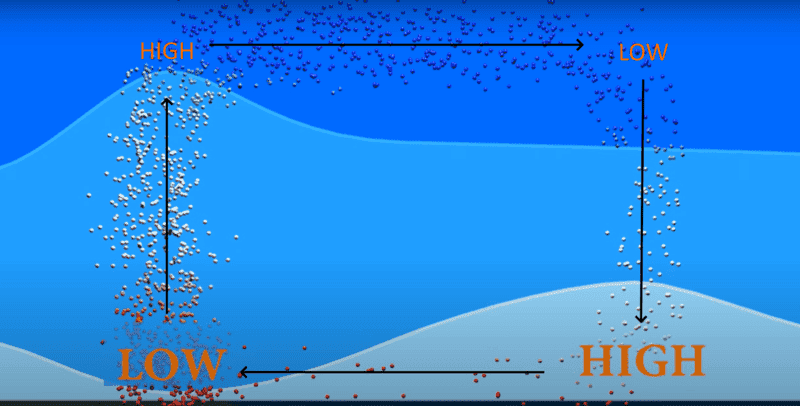

I was studying wind formation from the continent to the sea during day (direct circulation) and the explanation I found in almost all the textbooks was that:
1. In the continent during day the ground becomes hotter
2. The particles in the air increases their temperatures due to induction
3. When the air increases its temperature, the particles become far apart from each other, and the density reduces
4. Due to buoyancy, this air rises
5. As the air rises, for some reason, this creates a low pressure site at the ground and a high pressure site at the sky
6. The air now flows from the sky of the continent (high pressure) to the sky of the ocean (low pressure)
7. To complete the cycle the air drops (as it cools down) to the surface of the ocean creating a high pressure point at sea surface
8. Then it comes back to the continent
I can understand all the 8 statements, except the fifth. Why is the continent ground low pressure?

Now that I think about the figure a bit more carefully, I think the High and Lows labels are relating only horizontally and not vertically, otherwise we would have flow from low pressure spots to high pressure spots.
So we just have to argue why the air at the ground is of lower pressure with regards to the air on the surface of the ocean.

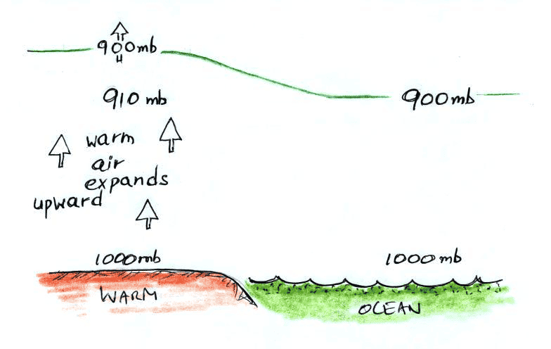

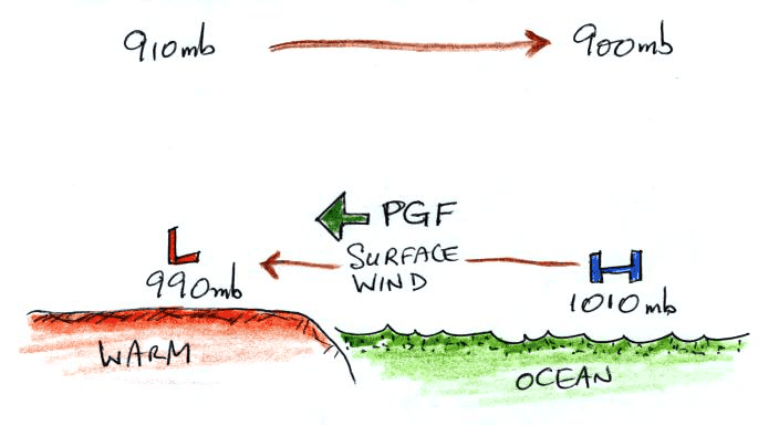

After reading the book @Chestermiller suggested and other books I think I got a qualitative answer:
As the movement is extremely slow we can say that the pressure in any spot is very close to the hydrostatic pressure in that spot (weight of the air column above).
First, continent ground is heated. This make air become less dense and dilate (upwards and sidewards).
The sidewards dilation contributes to the decrease in the pressure in the continent ground, as it decrease the weight of the air column).
The upwards dilation contributes to the increase in the pressure in the continent sky (as the baroclines will be shifted upwards).
Air then moves to the sky of the continent to the sky of the ocean.
As there are less air in the continent this contributes to a greater decrease of the continent ground pressure.
Some air will be stacked in the ocean now, more weight means more pressure in ocean's surface.
