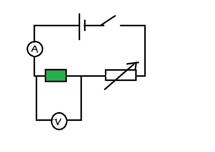

but in a circuit investigating the IV (current and voltage) characteristuc of a component, there's a variable resistor that will be used to vary to voltage (supplied to the tested component) or current (for the whole circuit. Then the figures for voltage and current will be plotted in an IV graph.
take a look at the whole circuit:
Variable resistor is shown by the rectangle with an arrow, the component tested is the green rectangle.
so why does it matter that the ammeter has a little bit of fixed resistance? because the resistance of the circuit will be changed anyway in steps (by the variable resistor) to measure voltage and current. Do you all get what I mean, I'm trying to say that it doesn't matter that the current reading on the ammeter doesn't give a figure for when only the tested component is in the circuit. What really matters for this circuit is that the ammeter shows the correct reading of the amount of current that flows through the component.
You've presented a particular instance in which the impedance of the ammeter is not a factor in the proper (desirable) operation of the circuit.
But your opening statement of the "problem" left considerably more leeway for interpretation; presumably an "ideal ammeter" is one that would be useful in any circuit, not just particular circuits where its changing the original circuit operation by its insertion doesn't matter.

It will be changed in known steps. The resistance of the ammeter is unknown and means all your current measurements in the IV plot will be offset by their true value for every voltage reading. You began by asking: "So if this ammeter is connected with a resistor, and the ammeter gives a reading of 10A, that is the true value of current going through the resistor," and the answer to that is no, whatever other stuff you want to throw into your circuit.

... What really matters for this circuit is that the ammeter shows the correct reading of the amount of current that flows through the component...
The ammeter in the circuit measures the current through the required component plus the current through the voltmeter.
What gneill said. In some cases it doesn't matter but in most cases it does.
Regarding your circuit... Suppose that instead of characterising the device in green you were using the meters and potentiometer to set the current and voltage to a particular value. If the ameter has internal resistance when you removed it from the circuit the current would change. To set the current to the right value you would need to know what the meter resistance was, calculate how that affects the current and set it accordingly. That's not too difficult when it's just a resistor but what happens when the device is an active component? In some cases inserting the ameter might turn the device off so the current can't be set.
Your circuit shows both a volt meter and a current meter. Have you considered that the input impedance of the voltmeter also affects the current meter reading? If the voltmeter is also non-idea your charaterisation of the device in green will also be off.
