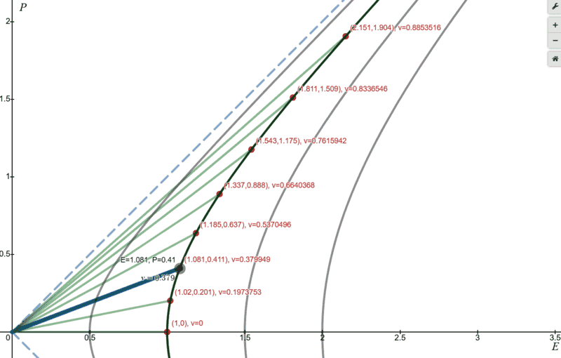

For this question there are several different equivalent ways of seeing the fact that you cannot travel at c.
My least favorite is, unfortunately, the one that is most commonly given in pop-sci sources. That is the “relativistic mass” argument, basically as you approach c in some frame your “relativistic mass” diverges to infinity. I dislike this explanation because “relativistic mass” is a useless concept for the reasons you stated among others. Please, if you gain nothing else from this reply, at least learn to ignore any source that uses relativistic mass. Serious sources abandoned the concept 60 or 70 years ago or more (its problems were recognized by Einstein late in his career even earlier), so sources that use it are either not serious or are outdated. “Relativistic mass” is now a hallmark of a source to ignore.
My favorite approach is the momentarily co-moving inertial frame. Any massive object has a momentarily co-moving inertial frame. In that frame the speed of light is c and the speed of the object is 0. So you cannot even approach c from your perspective and that translates to never reaching c from another perspective.
Another good approach is the relativistic velocity addition approach mentioned above. Each time you try to add 10 mph from your frame you actually add a bit less in a fixed inertial frame.
Another good approach is the mass approach, but it requires four-vectors. Once you learn four-vectors you will find that any object with mass (real invariant mass, not relativistic mass) has a timelike four-momentum. And any object with a timelike four-momentum has a timelike four-velocity, which means a velocity less than light.

To answer your question about why we can't reach light speed:
Start with the relativistic velocity addition equation (more Google, and the simplest form is ##w=(u+v)/(1+uv)##), compare with the velocity addition equation from classical physics ##w=u+v##.
Now consider a rocket that can accelerate itself from zero to .8c (relative to someone who is at rest relative to the rocket before we fire the engines, and remains at rest). Say that rocket is already moving at .2c relative to us, and we want to fire its engines to goose its speed from .2c to c relative to us... But the velocity addition rule tells us that although the speed of the rocket increases from 0 to .8c relative to someone initially at rest relative to the rocket, the final speed of the rocket relative to us is not ##.2c+.8c## but something less. No matter how much fuel we pump through the motors, no matter how much we increase the speed of the rocket relative to its previous seed, we can never get it up ##c## relative to us.
