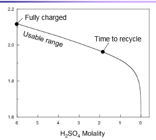

Think about what's happening around the battery plates
Current has to flow through the electrolyte by ion migration
In a battery that's really badly run down the electrolyte is depleted of ions and the plates are coated with sulfate, both of which increase its resistance.
As you see, at 1 volt per cell electrolyte molality is quite low. Few ions left to conduct.
That's why your charger when connected to an absolutely dead battery initially shows low current .
A battery that's not so badly run down will accept more current.
That's where you can get into trouble with sparks and hydrogen.

volts vs molality plot came from there

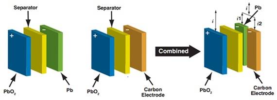

A very good article. I've always liked http://batteryuniversity.com/learn/. They have a neat New Lead Acid Systems article where Carbon is added to the negative plate.
Scientists have known for years that sulfate accumulation prevents the classic lead acid from delivering sustained performance; partial charge and aging are the main culprits. The Advanced Lead-carbon (ALC) solves this by adding carbon to the negative plate (cathode). This turns the battery into a quasi-asymmetric supercapacitor, improving charge and discharge performance.
