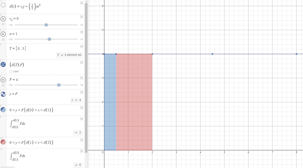

Here's a desmos visualization to see how the work done increases for equal impulses
because the displacement increases for the same elapsed 1-sec interval.
https://www.desmos.com/calculator/w9z3m57udi
This is a net-force vs displacement plot.
The net-force is constant.
The dots mark the displacement at t=0s, 1s, 2s, etc.. (same [itex] \Delta t=1 s [/itex]).
The work done during each interval (= the change in the kinetic energy)
is the area under the graph.
Note how successive impulses are accompanied by increasing work-done due to the increasing-displacements.
So, the extra KE comes from the increasing [itex] \Delta x [/itex] needed to obtain the same impulse [itex] \Delta p [/itex].
[I should have encoded [itex] F_{net}=ma [/itex] (by using the a-slider for F) in the desmos visualization.]
