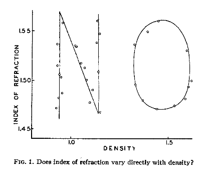

Before determining why something is true one should determine if it is true. It is true that light travels more slowly in a medium than in vacuum. But does the speed of light (or equivalently, the index of refraction) depend on density? Let's look at the data.
Likes nasu
To be clear I am sure vanadium is disputing only the OPs questioning supposition that perhaps the index of refraction is related directly to density. Asking why light moves slower in a medium is a perfectly reasonable question.
Which is why I wrote

Actually, come to think of it the difference in index of refraction between specifically air and glass IS to some large extent due to the density. Air has a LOT less charge to polarize per unit volume than glass. You know for example that the index of refraction of a gasses below high pressures does in fact vary linearly with density. Also you know in general gasses all have very low indices of refraction compared to almost all solids and liquids. Yes the bonds have different transition dipole moments, and, yes without a band structure there is effectively a lot less freedom for the charge to interact, and yes the refraction will depend highly on the proximity to absorptions, etc. But you can't discount density particularly when comparing gasses to solids. Solids tend to have similar charge density, so the density is less critical than the electronic structure. But if you REALLY change the density, then it has to count in some significant way.
