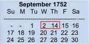

I am suppose to write a code that calculates the number of days between two dates and i get everything from the test correctly except the last one, 1900,1,1,199,12,31. I get +1 day, why is that?

Do you know that there are no leap years on the 100's that are not divisible by 400?
Likes jedishrfu
I did not know that, thanks :-)

Also historically there was a calendar change in 1582 by Pope Gregory to fix the time of the vernal equinox which was 10 days too late:
http://www.findingdulcinea.com/news...this-Day--In-1582--Oct--5-Did-Not-Exist-.html
The change from the Julian calendar to the Gregorian calendar didn't happen uniformly in all countries. In Great Britain and the colonies (including what is now the U.S.), this change didn't occur until almost two centuries later, in September of 1752. Here's an image of a calendar from that year. Notice the jump from Sep 2 to Sep 14, with no dates shown for the intervening 11 days.
