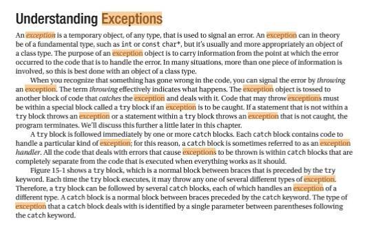

I followed the program from the book and it doesn't work. I simplified to show what's going on. I solve the problem and show in the second program. It's the good old cstring and the string literal again.
This is from the book, it doesn't work:
The error is:
I experimented and made it work, this is my program:
Only difference is I throw a cstring Cr that contain "Alan". It works.
This is my first day on this, I have no idea why the one in the book doesn't work and why it has to be like what I did to make it work.
Please help explain this.
Thanks
