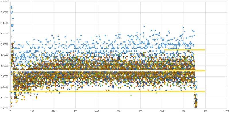

Hello Gentlemen,
I'm not an EE engineer, yet trying to help my colleagues. I would like to get a general feeling of what could be going on.
Probably trivial for some of you.
Background
We have a motor/torque sensor device that is measuring torque values. We get out digital signals for Torque and Position.
Below you can find a simple plot of a bunch of torque curves (several repetitions of the same experiment).
Plots are simply Torque vs sampling point count.
Question/issue
As you can notice from the the torque curves, there seems to be torque values that are "not used" by our sensor. Empty bands, no matter what.
I could define them as "gaps in the measurement resolution".
The only remarkable detail is that I seem to see 1 "resolution gap" every 16 resolution points exactly.

Look at the actual data before it is scaled for the plot. Are there gaps in the data?
It could be a beat between the quantisation of your data and the vertical axis of the scale.
I know nothing about EE sensors, and there are way more knowledgeable people here - so take this for what it's worth - but this pattern looks familiar to me from other contexts.
If the sensor's resolution is not the same as the graph's resolution - for example the sensor outputs 15 subdivisions per unit, and the diagram's resolution is 16 increments per unit, the renderer may be rounding the numbers, causing it to skip one.

DaveC426913 said:
The upshot is that, ostensibly, it is only an artifact of graph rendering, not an error in measurement.
Solution: play with the rendering - esp. the vertical scale - until the artifact goes away.
[Yeah, @Baluncore expressed it much more eloquently.]
Hi Dave,
thank you for your fast feedback.
I gave a look in the meanwile: the data showed you is already my raw output from our bench (as raw as I have access to).
I just placed it in a simple Excel scatterplot and magnified to see those bands clearly.Could it be that there's a similar upscaling/rendering issue in the measurement system itself?
Is it common, to have a measurement device hooked up to a "controller" that has a different resolution --> leading to this "aliasing" kind of issue?Thanks again!
Yes. That is almost certainly the case.
No, because the problem would be identified and fixed. That is what you must do now. It could be a fault in an AD converter. What type of AD converter is used? Is there another system somewhere you could borrow to do an exchange test to isolate faulty equipment?
Can you attach a copy of the initial data file, before you loaded it into excel. I would like to see the data you got from the sensor so I could do a statistical frequency analysis. That might give a clue to the quantisation forbidden zones at 3.15, 3.35 and 3.55 .
Please provide a better description of your setup. A block diagram of the test bed with instrument make and model showing data flow.
Also, can you generate a long slow change in physical torque to produce a slow linear numerical ramp. Ideally two to ten identical values before the next. Those numbers can help to identify the reason for the missing codes.
I think that could be the problem. If the ADC is not linear, in as far as it has gaps or overlaps in its transfer characteristic then there will be input analogue levels that either don't appear at all or which are duplicated.
There are many different possible designs for ADCs but this application seems to be pretty undemanding. The in/out curve should always be monotonic (maybe not a straight line) and with no gaps.
I'm not a big fan of 'valve changing' - a technique (old valve sets) of problem solving which used to consist of changing the valve that goes most often, then go for the next most likely etc.. Can you change the ADC conveniently?
I am not suggesting a swap of an A-D chip, but a complete instrument swap to see if the fault moves with one particular instrument. I tend to design parallel systems using duplicated modules, since that enables swapping modules as a way of substitute testing.
