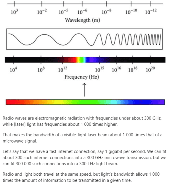

Sorry, link to Quora didn't work, for whatever reason, so it has to be a picture:

It may be due to the size of the remote antenna, measured in wavelengths.

IDK. It's really about SNR of the recovered signal though. More noise can be fixed by more source power. Absorption is also a thing; what about clouds and such. It's also about the filtering and detection functions at the receiver front end. It's hard to find good comparative data since they each live in their own silos.
