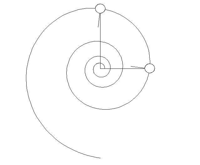

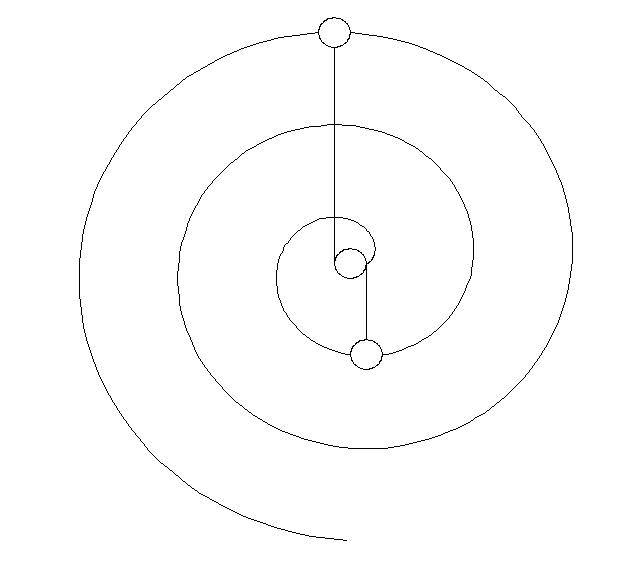

Assumr a puck on a frictionless surface attached to a string that goes through a hole in the surface and that the puck is traveling in a circular motion. There is a Newton third law pair of forces between the puck and string, the string exerts a centripetal force on the puck, and the puck exerts a centrifugal reactive force (a reaction to the centripetal acceleration) onto the string. (In a rotating frame, there is a fictitious centrifugal force, but I'm assuming this not what is being asked about).
Athi Sankar said:
Acceleration of a rotating link has two components,Tangential (change in the direction) Radial (change in the magnitude). Why the direction of Radial acceleration is considered towards center (Centripetal)?
The "radial" force is the force perpendicular to the velocity of an object, and points towards the instantaneous center of the curved path.
Going back to the puck on a frictionless surface and a string through a hole, note that if the string is pulled inwards, the puck follows a spiral like path, and that a component of the tension in the string is in the direction of travel of the puck, changing the speed of the puck as well as the direction. In this image, you can see that the force is not perpendicular to the path of the puck:
If the string is winding or unwinding around a pole, then the tension will remain perpendicular to the puck, and the pucks speed will not change. The path is "involute of circle".
Is this common language? When I hear the words “radial” and “tangential” I automatically think of parallel and perpendicular to the position (from some origin), not to the velocity.
In other words, in my mind, “radial” and “tangential” are verbal references to a polar coordinate system.
Of course for circular motion, our interpretations are the same. But for general motion (like in @rcgldr’s spiral example) the meanings are different. In my view, I would say, “there is a radial component of velocity for non circular motion.”

I had a feeling you were silently assuming circular motion, but @rcgldr explicitly says:
With an example of spiral motion! Quite an unusual interpretation of the word radial.
At every point on the spiral trajectory the path is momentarily approximated by a circular arc (which will not be centered on the center of the spiral). One would often use such a curved tangent arc to determine how to split an acceleration into "radial" and "tangential" components.
I’m familiar with the concept of curvature, but does anyone actually mean that by “radial”...?
I have only ever heard that basis referred to as “tangent, normal, (bi-normal)”
It just seems odd to call the normal “radial,” but if people do call it that, then that’s fine, I am not the decider of semantics.
