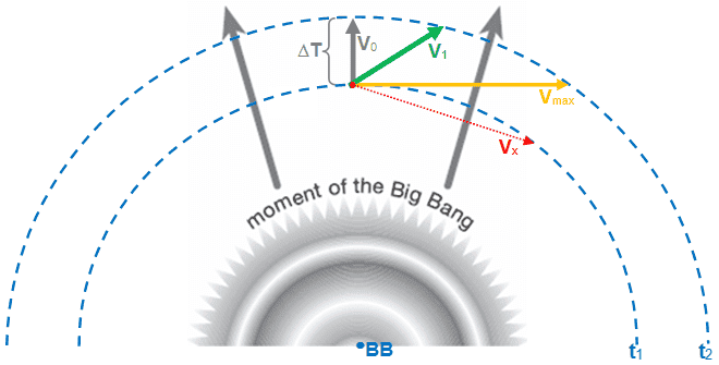

So, how might this apply to universal speed limit c? Consider Sean Carroll's depiction (guidebook p.77) of time. Like gravity or an electric field, it emanates from a charge, in this case the Big Bang event and one dimension up (a 4D temporal field). I've adapted his 2D cross section, by adding two spatial simultaneities as arcs "now" (t1) and "future" (t2). This is roughly consistent with the "balloon analogy" for cosmic expansion of space.
I've also drawn some worldlines indicating velocities. From a point "here, now" (red dot), zero velocity (V0) is normal to space, while increasing velocities (V1) find a natural and universal limit (Vmax), tangent to space and enforced by the fundamental unidirectional nature of time. Thus, Vx is disallowed. In such a curved-space, radial-time model, space is derivative, providing bidirectional freedom to the extent that it does not violate the direction of time.
Do you have a reference for this model, or is it just your personal construction? If it's the latter, please review the PF rules on personal theories.
This is incorrect as a description of any actual spacetime model--not just the one used in cosmology to describe our universe, but any model consistent with GR and the Einstein Field Equation. In any such model, a vector that is "tangent to space" will be spacelike, not null. (For example, your vector ##V_x## should be "tangent to space".) So your model does not appear to correctly represent the physics.
This is true of any model consistent with GR and the Einstein Field Equation as well, so I don't see the point of your alternative, particularly as it contains a key error, pointed out in my last post.

PeterDonis said:
In any such model, a vector that is "tangent to space" will be spacelike, not null. (For example, your vector Vx should be "tangent to space".) So your model does not appear to correctly represent the physics.
Yes, in Minkowski spacetime, "tangent to space" is the spatial coordinate of the given frame. That assumes flat space (locally, at least). Note that in the diagram as I adapted it, a lightlike interval remains null but it's direction is tangent to the given curved space (rather than having Minkowski's slope 1).

PeterDonis said:
[Mysteries of the Universe: Time - by Sean Carroll] Is a pop science reference, not a textbook or peer-reviewed paper. I'm looking for the latter. Even if they are written by scientists who have published textbooks or peer-reviewed papers, pop science books and websites are not acceptable sources
I'll make a note of it. Carroll is a widely recognized and awarded educator. Though not peer reviewed, I don't think he's attempting to mislead anyone with his 24-lecture course on Time, which I've viewed four times and highly recommend.
PeterDonis said:
in our current best-fit model of the universe, such hypersurfaces are flat, not just in a given representation (which might be distorted), but in reality--their spatial curvature is zero.
I understand your view but consider that current measures of flatness to provide only (an admittedly, very large) lower bound on any radius of curvature. Recall that science has repeatedly been surprised by prior estimates of the size of the universe. Also, when flat-looking representations of spacetime, such as Minkowski diagrams, admit to being non-Euclidean, aren't they effectively saying they aren't really flat?
"Minkowski space hence differs in important respects from four-dimensional Euclidean space."
PeterDonis said:
the definition of "space" as a spacelike hypersurface, i.e., a hypersurface all of whose tangent vectors are spacelike.
Yes, but I believe the tangent vectors you refer to apply to curves occurring within the spatial 3-surface.
"Technically the three types of curves are usually defined in terms of whether the tangent vector at each point on the curve is time-like, light-like or space-like. ...One can also define the notion of a three-dimensional spacelike hypersurface, a continuous three-dimensional slice through the four-dimensional property with the property that every curve that is contained entirely within this hypersurface is a space-like curve."
The lightlike velocity vector (Vmax) diagramed above is a tangent of the spatial 3-surface externally.
PeterDonis said:
Only if it properly represents the physics. Yours doesn't,
As with flatness, you seem extraordinarily certain. Your model describes but does not explain a universal speed limit essential to physics. The model I gave does. Nevertheless, a "model" only approximates reality (and often only specific aspects of it), otherwise it would be reality.
No. "Flat" in the context of spacetime means "Minkowski". More generally, "flat" for any manifold with a well-defined Riemann tensor means the Riemann tensor vanishes. Minkowski spacetime satisfies that definition.
Doesn't matter. Any curve that stays within a spacelike hypersurface will have tangent vectors that are everywhere spacelike.
No, it isn't. No lightlike vector can be tangent to any curve that lies entirely within a spacelike hypersurface. See above. The fact that your drawing represents it that way means your drawing is wrong.
That's because I am. I'm talking about precise definitions (of flatness) and proven mathematical theorems (about the properties of tangent vectors that I stated above). If you're not familiar with the relevant math, I strongly suggest that you become so. A good, if advanced, reference is Hawking & Ellis.
For your definition of "explain", perhaps not. For my definition of "explain", saying that the "universal speed limit" is a geometric property of spacetime is just fine as an explanation.
No, it doesn't, because it's incorrect. See above. An incorrect model can't explain anything.
