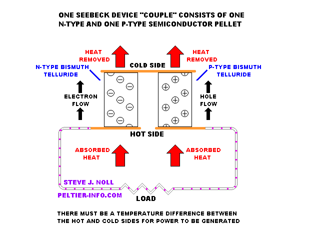

I just did a thermoelectric generator from seebeck plate. And when temperature increases, the plate's resistance increases from 12 ohms to 8 M ohms. Why is that and how todeal with it??
Probably everything you need to know is here: http://www.peltier-info.com/
Can you test a TE module with an ohmmeter? No - the DC voltage that a standard ohmmeter applies will cause a temperature change (Peltier Effect) which will in turn cause a voltage to be generated (Seebeck Effect) which will cause the ohmmeter to read strangely (drifting, and even a 'negative' resistance. So, then use the "diode test" position on the ohmmeter? No - even though a TE module is constructed of an array of N and P doped semiconductors there isn't an actual diode junction. A resistance test can be made with an LCR meter which measures resistance using an AC voltage.
If you like pictures like me, you and other readers may like this from the link.
