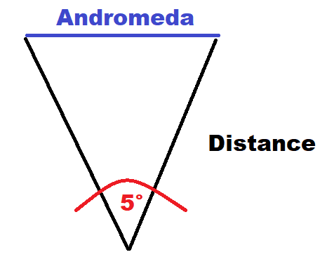

Hi, and thanks for reading. I asked this question in another forum too.
If we agree that Andromeda is 2.5 million light years away, and its diameter around 220,000 light years, I don't see how it just appears as a regular point of light like any other star in the unaided eye.
Something that so extensive is a little over 11 times away from us. For a scale comparison, the Earth is 30 diameters from the moon, or 30 times, and If Andromeda was the diameter of the Earth placed at the moon's distance, it would span at this distance 8 times a full moon.
Where am I going wrong with this?

We get an angle of ##5°## for the entire width of Andromeda, if we could see it in full length. But with the naked eye we only might be able to see the center regions with higher star density, say a third. Then the angle somes down to less than ##2°## which is very small.
I don't know how you're defining degrees, and what the overall dimensions of the Galaxy is, IMO it's similar to the shape of a hurricane.
5 degrees?

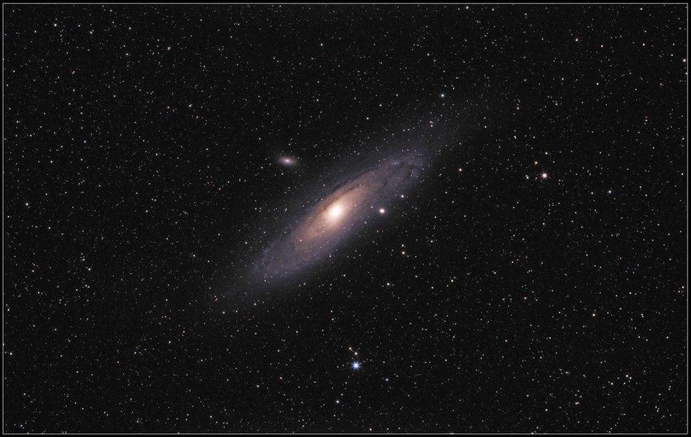

You started this thread asking about how it looks to the unaided eye. The image you posted came from a very powerful telescope (and depending on the source may also have been artistically enhanced to make it look even cooler). To the naked eye the Andromeda galaxy is just a tiny fuzzy patch, and as @Vanadium50 points out above, it's easy to misidentify it.
Yes, and it nowhere nearly covers such distance.
Likes ohwilleke
That's right, and @Andy Resnick explained why in post #2 of this thread.

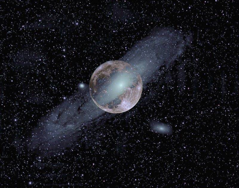

A picture is worth 1000 words: I 'added' pictures I took of the moon and Andromeda. Hope this clears things up.
That's amazing, I thought Andromeda was a barely visible point like blob because of the vast distance from us
lots of images on pf Our Beautiful Universe and I had no idea of its full size (if we could see it all)
