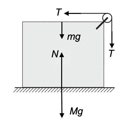

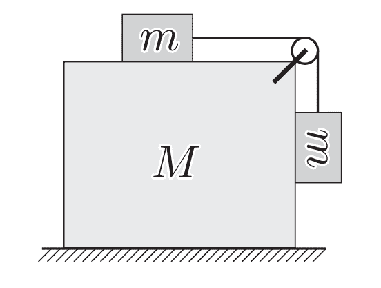

A block with mass M lies on a slippery horizontal surface. On top of it there is another block with mass m which in turn is attached to an identical block by a string. The string
has been pulled across a pulley situated at the corner of the big block and the second small block is hanging vertically. Initially, the system is held at rest. Find the acceleration of the big block immediately after the system is released. You may neglect friction, as well as masses of the string and the pulley.
$$ \sum F =ma$$
Clearly, in the picture I can see that on the small block on top, tension and gravitational force act. Gravity gets balance by the normal force, so tension is the only force causing acceleration. On the block at the side gravity and tension result in vertical acceleration. However, I do not see any force acting on the big block except the normal forces and gravity, which appear to me, to balance out. So, which force am I missing out on that causes the acceleration? And after that how should I go about finding the constraint equations? Any help would be appreciated.
I have also attached the given answer.
Conceptually:
Where is the centre of mass (approximately) of the entire system at the start?
If mass M did not move, where would the centre of mass of the entire system be (approximately) at the end?

DaveC426913 said:
Conceptually:
I think I might've read something like this somewhere. Centre of mass at the start would be somewhere between the three masses, but closer to the big block. At the end, if the big block didn't move, it probably would shift somewhere away from that point. But no external force acts on the system, so that shouldn't happen.
Is this reasoning proper sir? Even if it is, I don't know, how it express it on paper in this context.

As gravity on the side block impels the top block toward the pulley, it also impels the pulley toward the top block, and the pulley is affixed to the big block. If you imagine the top block held in place, the side block could not descend without moving the larger block. If you imagine the density of each of the 2 smaller blocks to be much greater than that of the larger block, it's perhaps easier to see that the larger block would move ##-## a lesser-mass large block would move more than a greater-mass top block.
Likes rockinwhiz
Okay, I think I see something here. So, the tension in the string would also act on the big block, to drive it in the opposite direction as the top block, I guess? I think that works. That gets me the answer too. But if there are any nuances, then kindly point them out as well. Thank you!

Another way to think about forces here: look at the pulley at the top right. Are there any forces acting on the pulley from the tight string?
Likes Lnewqban and PhanthomJay

rockinwhiz said:
... However, I do not see any force acting on the big block except the normal forces and gravity, which appear to me, to balance out. So, which force am I missing out on that causes the acceleration?...
There is a reaction force at the support of the pulley.
If we decompose it into x and y imaginary axes, ##R_x## would be the force you are missing out.

One thing I'm not sure about, is the acceleration of the large block uniform? It is in the case that the suspended mass is constrained to move down a rail attached to the side of the large block, but I'm not sure if it will still be uniform if the suspended mass can swing all over the place. A non-uniform acceleration of the larger block would seem to imply that the equilibrium angle is a function of time. Is that vaguely right?

No. It will not be. If you change the angle of the vertical[-ish] string segment, you change the vector sum of the tensions on the pulley and, hence, the lateral thrust on the large block.
There is no corresponding increase in string tension (which, if anything, would scale with the cosine of the angle from the vertical) to go with the change in lateral thrust due to angle (which would go with the sine of the angle).

A lot has been said already, I agree with most but not all of it. When I first solved this problem I went back to basics to answer the original question, "Find the acceleration of the big block immediately after the system is released." To do that, one needs to draw a free body diagram (FBD) and then apply Newton's second law. Here is my FBD with the assumption that immediately after release, the hanging part of the string is vertical and the tension is ##T=mg##. I did not include a normal force exerted by the block on the hanging mass because that force is zero at ##t=0## and remains zero as the block accelerates to the left at ##t>0##.
This FBD and the ##T=mg## assumption do not result in the purported answer. Based on the above, one can find the horizontal acceleration is one's head. Has anyone obtained the answer ##a=\dfrac{mg}{(2M+m)}##? Because of PF rules, I cannot post my derivation here, but I will be happy to send it to you by PM. However, if you find the error of my ways on the basis of what I have already said, I will welcome your reply here. As some of you already know, I have an occasional blind spot.
