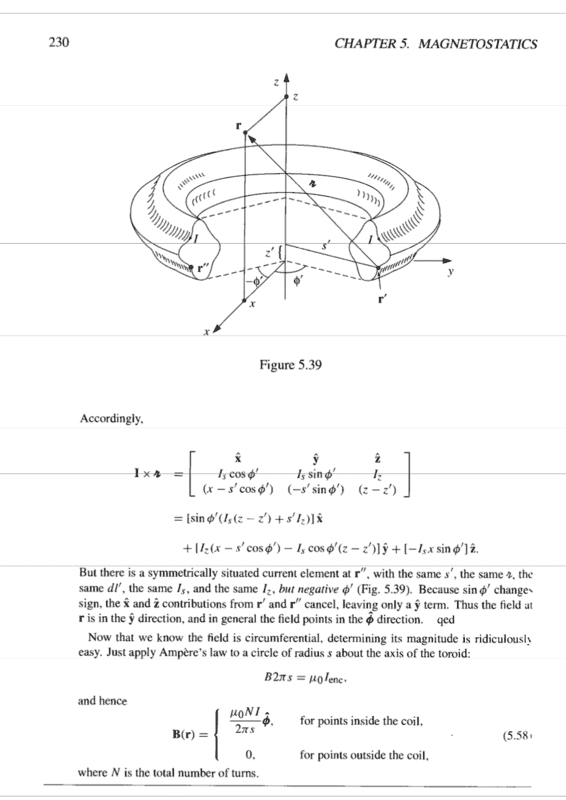

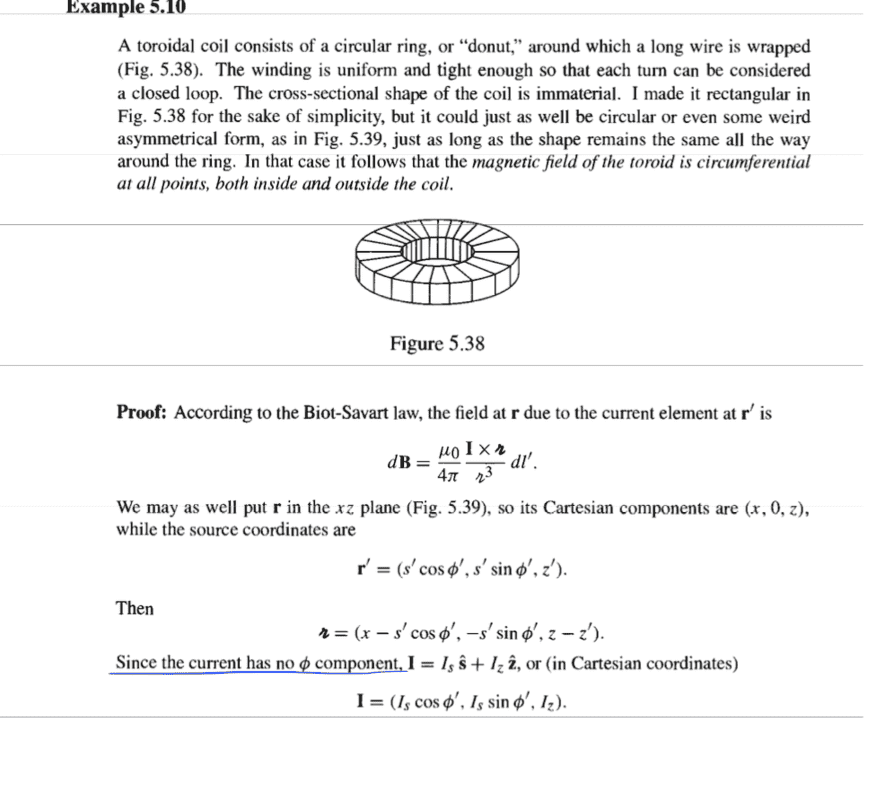

These are images from the book Introduction to Electrodynamics by David J. Griffiths .
My problem is that I'm unable to understand how the current has zero ##\phi## component (I have underlined it in the first image)? I do understand cylindrical coordinates, I know cylindrical coordinates involve three components ##(r,ϕ,z)##and ##\hat{r}##r^ points radially outwards, ##\hat{\phi}## points perpendicular to ##\hat{r}## and even to ##z## axis.
I fully understand this image (credit: https://physics.stackexchange.com/users/110781/frobenius)
But in spite of all these I can't seem to understand how the current have no ##\phi## component. Well, in that toroid we have current going on in circles and really I don't anything more than this.

This thread is a mess.
I refer to the first drawing. The other two seem unrelated to the problem.
There is no calculus required. There is no current in the phi direction because the problem defines it that way. Look at the drawing: the wires go up in z, in in r, down in z, and out in r. They do not go in phi at all. Since the wires don't go in phi, neither does the current.
If you want to argue that this is an approximation of a physical toroid, we can go down that route, but that is not the problem as asked.

But in the second figure (where the cross-sectional area is weird) I’m having trouble in seeing how it doesn’t have a phi component.
You have made it very clear to me about how phi component is zero in the first figure.

Actually, if you look at that example, Griffiths is explaining everything with the help of that 2nd figure (that weird cross sectional area in the 1st post) so it was quite obvious for me to take his words “the ##\phi## component of the current is zero” for that 2nd figure.
I want to know is the ##\phi## current zero in that 2nd figure (of my first post)?

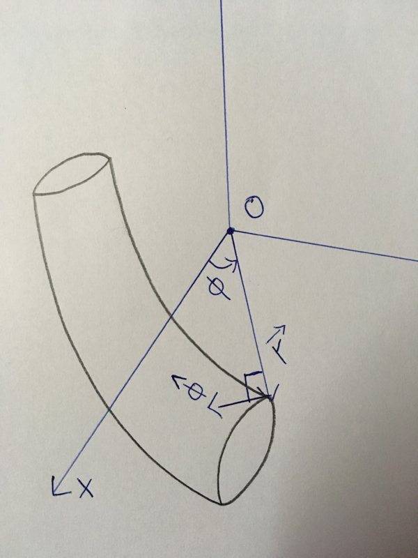

When the cross section is rectangular I can see that ##\phi## current is zero.

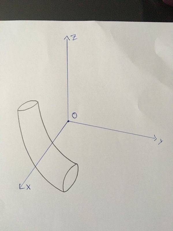

But now let’s imagine, we got a slinky and we join it end to end to form a toroid, now since the cross-sectional area is circular then definitely we have a ##\phi## component. Even if the turns are so close to each other then also we have a circular cross-sectional area, and a circle’s line element does involve a ##\phi## component.
Yes it likely will have a very very small phi component but it could be wound in such a way that it was actually zero in the unlikely event it really mattered. Nothing is ever perfectly exact!
Can you please draw a figure (or at least guide me) to show how it got a negligible ##\phi## component? I’m really unable to see it.
Here are two figures that I tried to draw
